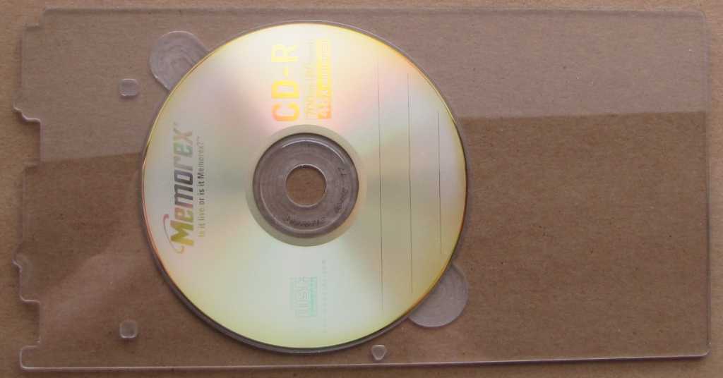

Making a Canon CD Tray

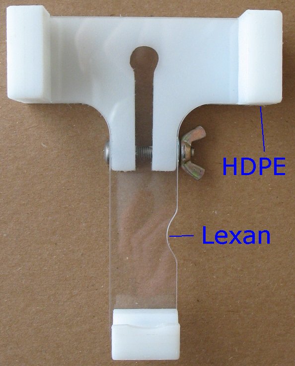

Making an automobile windshield holder for my GPS

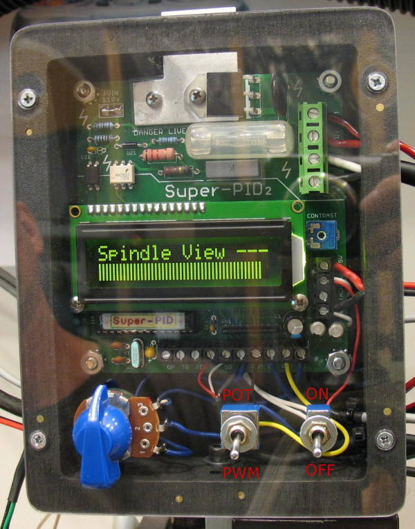

Guitar Amplifier face plates Printed Circuit relay Board - Spindle On/Off control

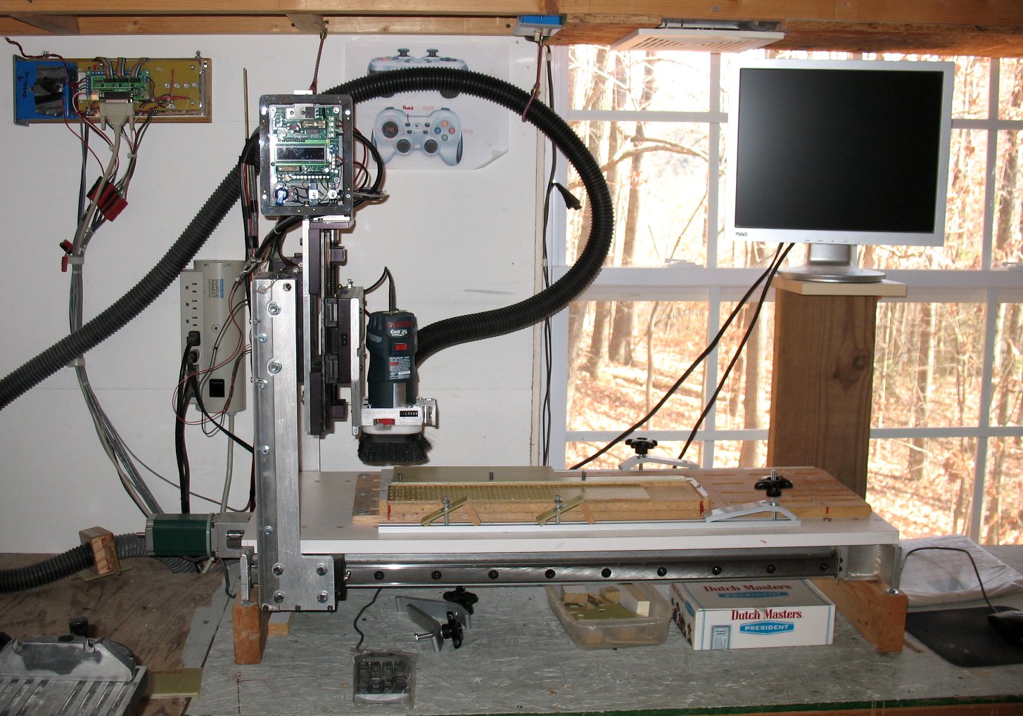

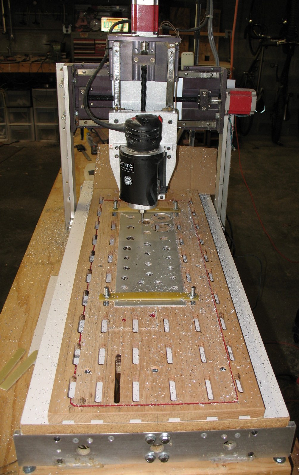

The New Aluminum CNC machine
The original Oak machine I built was great but I am ramped up the precision level by a factor of 10 by building a 6061 aluminum frame machine with some really nice THK parts.
The new machine uses a THK FGS 140 and 200 actuator assemblies for the Z and Y axis.
The X axis uses two THK HSR30H bearing blocks and 33" THK rails

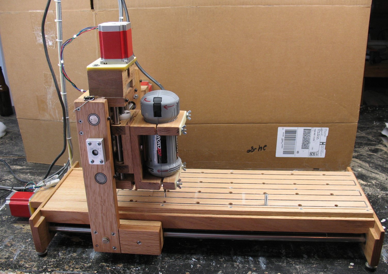

My first CNC machine
I decided to build a wood CNC machine first to iron out all the design elements, see what works and what doesn't.
I am using Red Oak for most of it. It's hard as rock, very stable and I had a bunch of Oak in my shop already.
I didn't want to use plywood or MDF, which is basically glued sawdust.
The Z and Y Axis parts
The X Axis and Table
Acme screws, Shafts and Bearings All the parts assembled and a working router

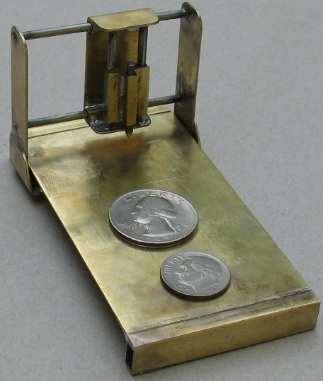

Go here to see the miniature brass CNC router I built
Mini Brass CNC Router
