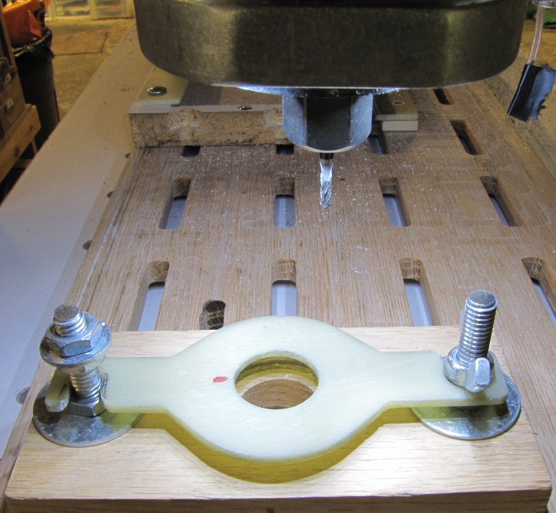

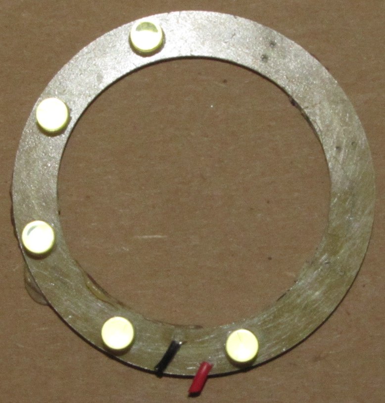

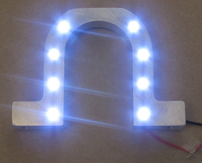

| The old LED light ring with 3 sheared off LED's I had previously made an external LED ring and liked it, but I kept shearing off the LED's one by one. Tool changes with wrenches and work piece clamps were able to shear off the external LED's on my first ring Time to make a new and improved model |

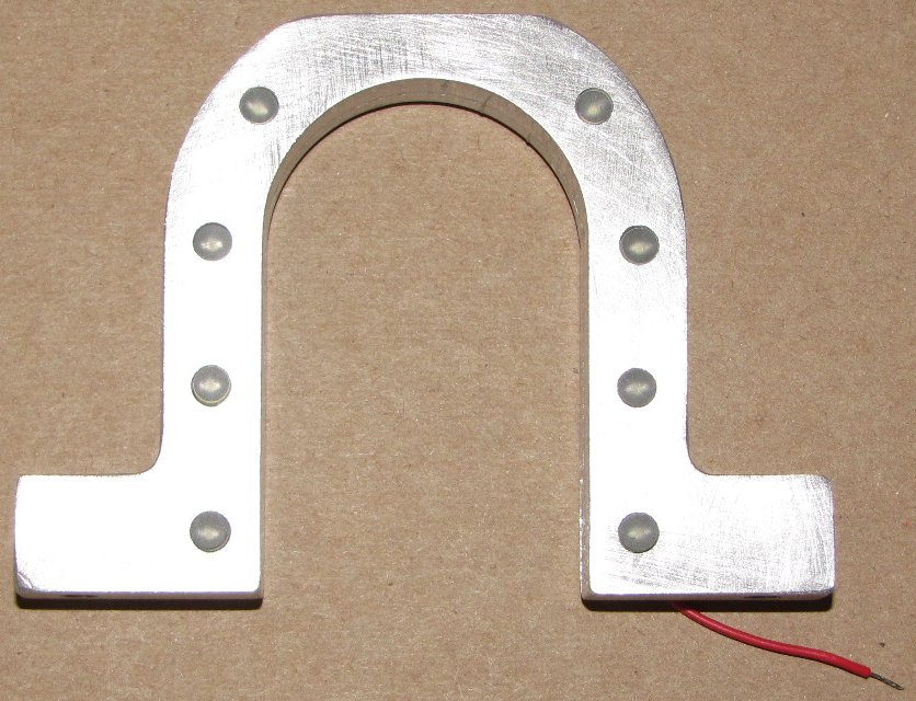

| This is the metal piece that clamps down the business end of my Rotozip tool. I drilled 8 holes into it so I could install the LED's into the metal If the top end was not flattened off, I could have installed one or two more LED's I did not want to drill holes in the thinner flat area and risk weakening it. If I make another one of these metal pieces for my CNC, I will design into it the LED holes and a wiring groove. I used 14000mcd LED's for this project You can get 20 of these LED's for cheap at this web site with free shipping http://www.dealextreme.com/details.dx/sku.1106 After I installed the LED's, the rounded tips of the LED's stuck out past the metal. One problem is that the rounded ends of the LED's tend to focus the beam into a spot beam pattern. It looked like 8 round circles when they were lit up. I laid the metal piece on my bench belt sander and flattened the tips of the LED's flush with the metal surface. The beam pattern is now much broader and less of a spot beam The beam shape turned out great. |

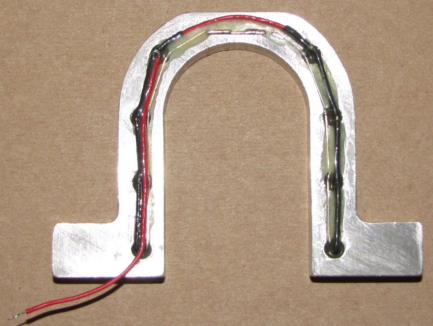

Here's the back side showing the LED wiring. I made the bare LED Negative wires touch the metal so I could use the machine frame for the LED negative The RED wire is the LED positive wire I run the LED's on 5 volts DC at around 30ma each using a 5 volt wall wart I installed a 2 ohm current limiting resistor to get the current set at 30ma each All the LED's are wired in parallel. I mixed up some two part epoxy and gooped it into the back of the LED holes and all around the wiring to keep everything in place I wish I could have machined a groove and recessed the wiring down into the groove. I could not do that because this is the piece that clamps down the Rotozip Can't do any machining without this piece attached I would have to make a new one from scratch. |

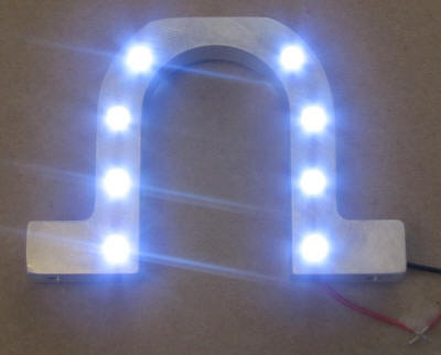

| Here's the LED's lit up on the work bench Doesn't look like much at this point |

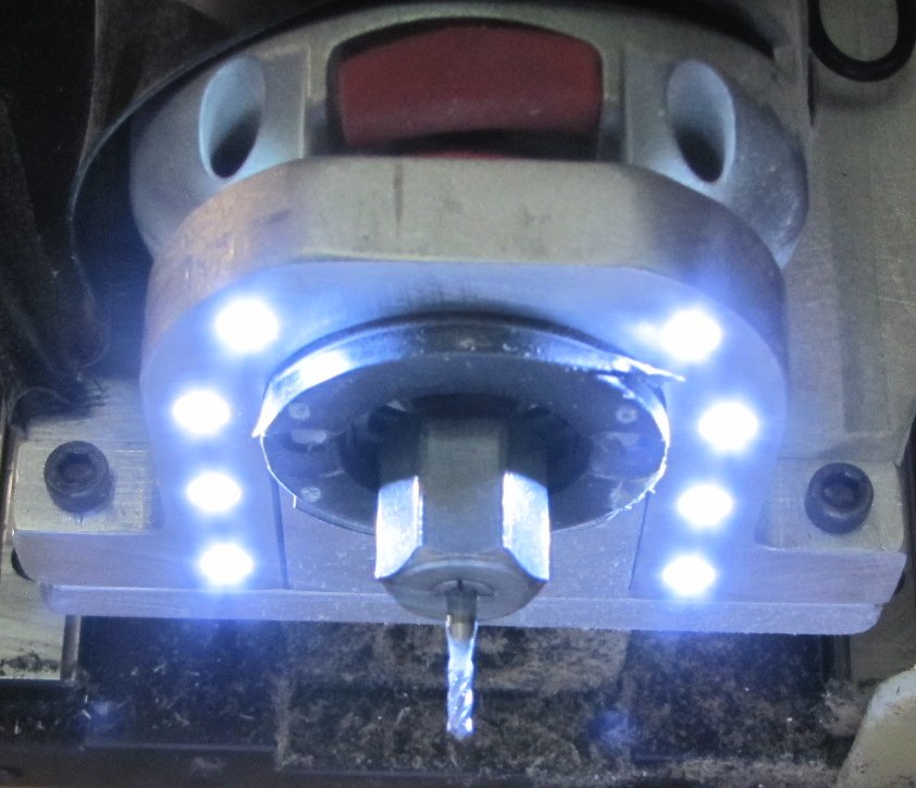

| Here's it is installed on my CNC machine Still doesn't look too impressive |
| Click on the images to see a larger image |
| Ok, now it looks like something is happening All 8 LED's beam shape are spread out and overlap nicely The only lights that were on in my shop were some florescent shop lights at the back of the shop All in all, I like how the CNC light project turned out I won't be shearing off the LED's anymore |
