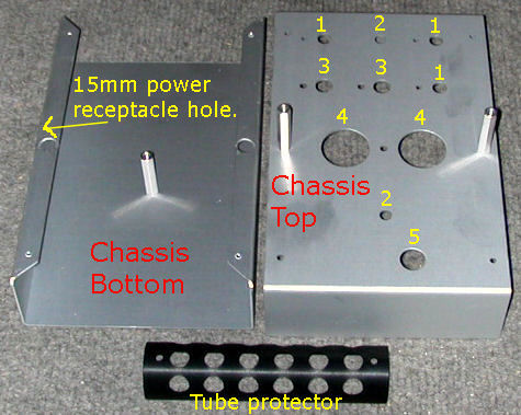

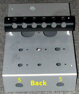

This box is all aluminum construction and it looks to be 1/16" inch thick. It has a black tube guard that stands up on 1 1/4" hex standoffs. The black tube guard mounts to the standoffs with two #6 screws. There is also an internal hex standoff that supports the center section between the two tube holes. It comes with a package of chassis screws and rubber stick on feet.
Hole sizes
1 = 5/16", 2 = 1/4", 3 = 3/8", 4 = 1", 5 = 1/2"
There is also a 15mm power receptacle hole on the left side that is not visible in the photo. This would be for a female wall wart plug receptacle.
The small holes next to 1 and 3 is where the anti rotation tabs on Alpha pots go.
