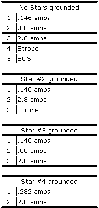

See the diagram above right that explains the different modes
The stock board is already set to Mode 1, no stars are grounded
You do not have to select a different mode if you want a strobe and SOS mode
What appears to be Star #1 is just a Star that is connected to the outer ground ring
If you want to select another mode, you have to ground one of the stars
Stars #2, #3 and #4 are the mode selecting stars
Solder a small wire from one of the stars to the outer gold ground ring to select which mode you want to use
I like Star#3 mode because it gives you 3 different light levels without the annoying strobe and SOS modes

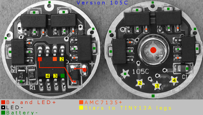

Use the diagram above left to follow the color codes described below.
The gold ring that surrounds the outer part of the board is Battery minus or ground.
If you solder a small wire from Star #3 to the outer gold ring, you are selecting mode 3
The green colored squares on the diagram above are Battery - or ground
Star 1 is just a star that is connected to ground
The Red dots are Battery Plus and LED plus (same thing)
The yellow squares show how the Stars are connected to the controller chip
The yellow stars are where you solder your jumper wire to select the mode you want
The Orange squares show how the micro controller chip is connected to the 8 x 7135 chips
The Orange legs on the 7135 chips are pulsed on and off to regulate the current at different levels.

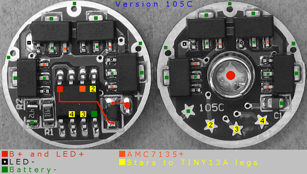

Assembly tip if you are using mode 3
I use mode #3 on the Marwi XML light I build
You can take a quick time saving short cut and solder a small blob of solder across the TINY13A chip legs to select mode 3
The two legs you use are the yellow #3 leg and the green leg to the right of yellow #3
See the picture above left that shows these two legs
The assembly page link at the top of this page has pictures of how I do this

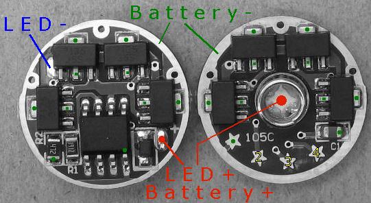

This is how you hook this board up to a Battery and a LED
Note that Battery + and LED + are the same thing
I like to connect Battery + and LED+ to the gold spring because it's easier to solder to this large area
There is a small solder pad with a + sign. You can use that pad for LED+ if you want to
Battery - can be soldered to the outer gold ring on any side of the board that you want.
Normally Battery - goes to a SPST On-Off switch first and then from the switch it goes to the board
This is how you turn the LED Off and on and change modes
The LED- solder pad is very tiny and can be tricky to get a wire soldered to it.
It takes a very fine tipped solder iron tip to do this
Do not blob solder everywhere and short out across other solder traces.
You are very close to the outer Battery - ring on the boards so be careful.
Never solder a wire to a trace and then try and bend the wire a different direction
You will rip the copper solder trace right off the board, or worse yet, rip a chip off the board
