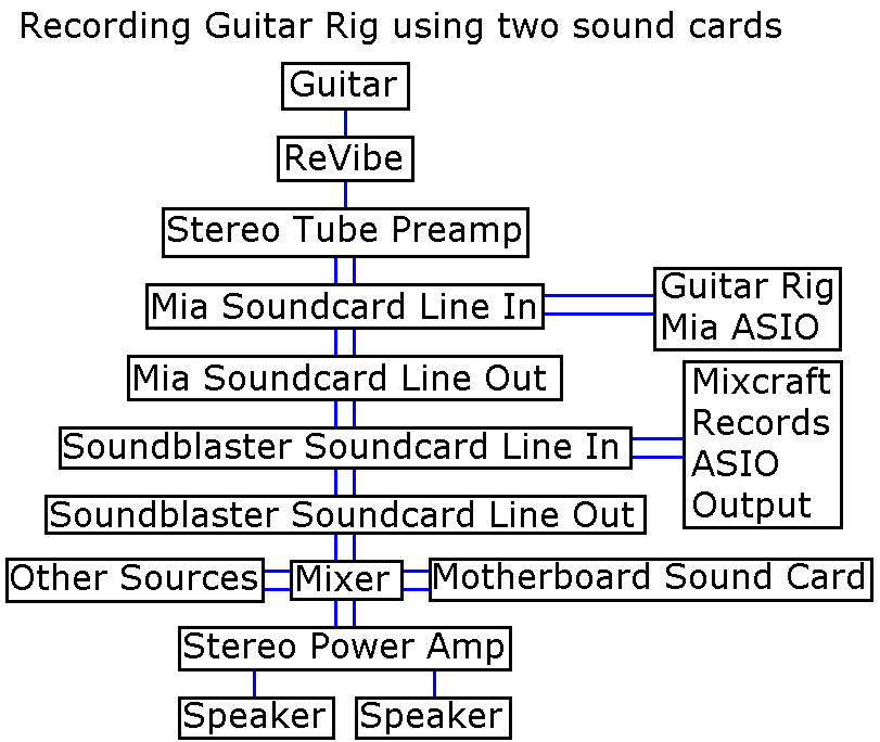

This is my current Guitar Rig signal chain
The Guitar plugs into my Stereo Rack tube pre amp
If I am doing Surf instrumentals I plug into my Rack ReVibe first and then the tube preamp
The Stereo signal out of the Tube pre amp goes into my Mia sound card
Then Guitar Rig processes the signal using the Mia ASIO driver
The signal then leaves the Mia soundcard and goes into the Line in on a Soundblaster Audigy sound card
I record this signal using Mixcraft and the Soundblaster Audigy's ASIO drivers
The signal then leaves the Soundblaster Audigy and goes to a simple mixer
The mixer can have several input sources all mixed together before that goes to a Stereo power amp
Then from the power amp out to to large speakers with 18" subs
