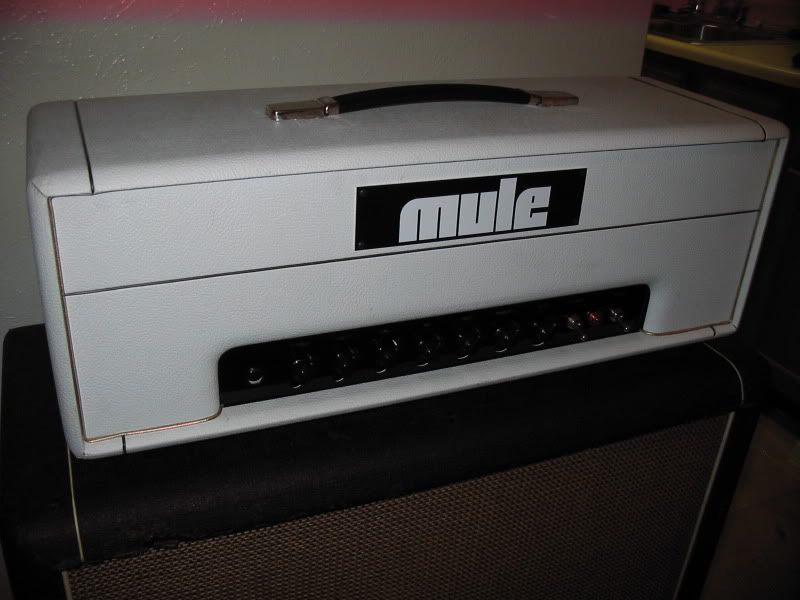

I was at my shop pulling parts for a 50 watt Plexi build for someone and i took a break to plug into the 14/7 (pentode/triode) #34 Mod amp i built a couple of yrs ago------ Three gain stage #34 Mod preamp into cathode biased EL84 x 2 (GE 6BQ5's). Ran it thru a Hiwatt 4x12 cab.
What a fun rock amp to play !!! I don't see that more than 3 stages are needed to get similar tone to the vid above--- and this 14 watter doesn't need an attenuator-- :l2:--- it also has an adjustable NFB pot to get more/less overall hair into the tone.
I recently got this one back from a local studio that keeps borrowing it for recording purposes:
Offline Colas LeGrippa
  • Posts: 2204
  • MAKE LOVE NOT WAR
Re: S T A A L H O O F D mod
« Reply #21 on: December 07, 2011, 04:20:48 pm »
very neat amp
P.S.: call me Alvin.
