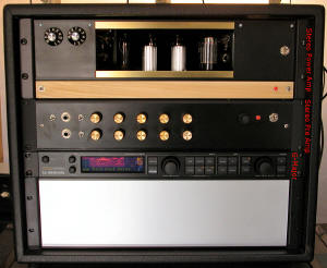

Front view of my rack setup
I added a black face plate to the Stereo pre amp. It is made of Black Garolite epoxy board. Cost about $2.50 to make. I will figure out the lettering at a later date.

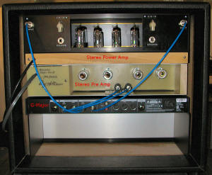

Rear view of my rack setup.
You can see info on the Stereo power amp on my library page.
