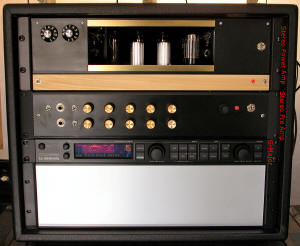

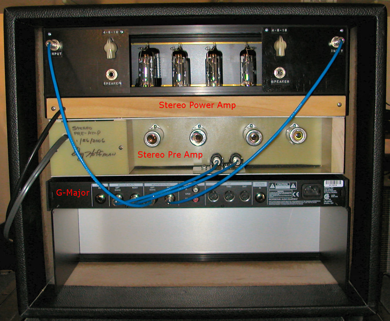

Front view of my rack setup Rear view of my rack setup.
