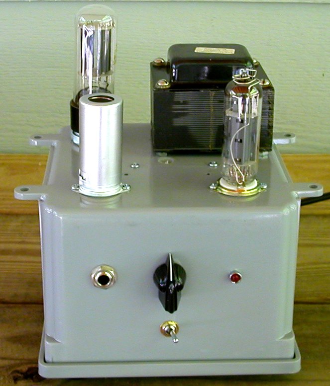

  I was walking through Lowes home center one day and I spied this cool gray Schedule 40 PVC electrical box for $10. I have seen amps built into lunch pails and mailboxes so I decided to give this box a go. It's built very solid, the walls are approx. 3/16th inch thick. The bottom plate has screws on all four corners and I have mounted 4-rubber feet to the bottom plate.
  The front controls are left to right. Input jack, Volume control and LED pilot light. The bottom switch is a bright switch that switches a 250P cap across the volume control. The 250P cap sounds great with single coils but was kind of buzzy with humbuckers so I made it switchable.
Hopefully heat will not be a problem. Schedule 40 PVC is very tough stuff and I have tested the amp for hours at a time with no heat problems so far. I may have to vent the insides since there are a few heat producing resistors inside. I'll vent the case if it becomes necessary.

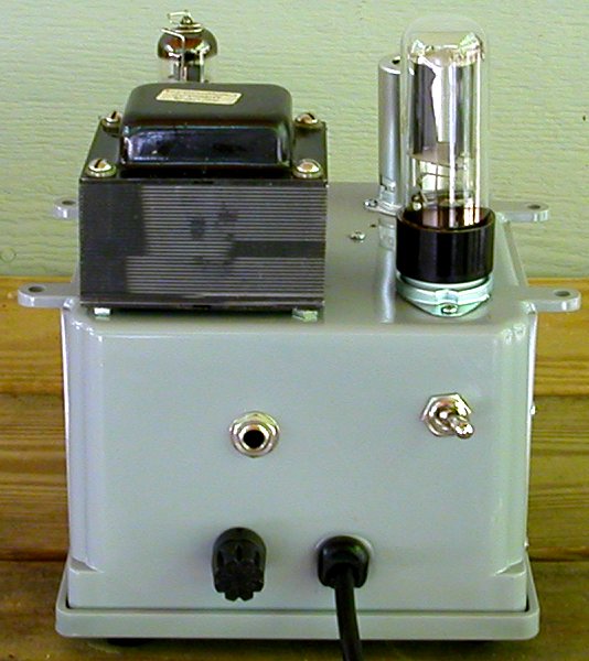

The rear panel from left to right: Upper row - Speaker jack, On-Off switch. Lower row - Fuse holder and power cord.

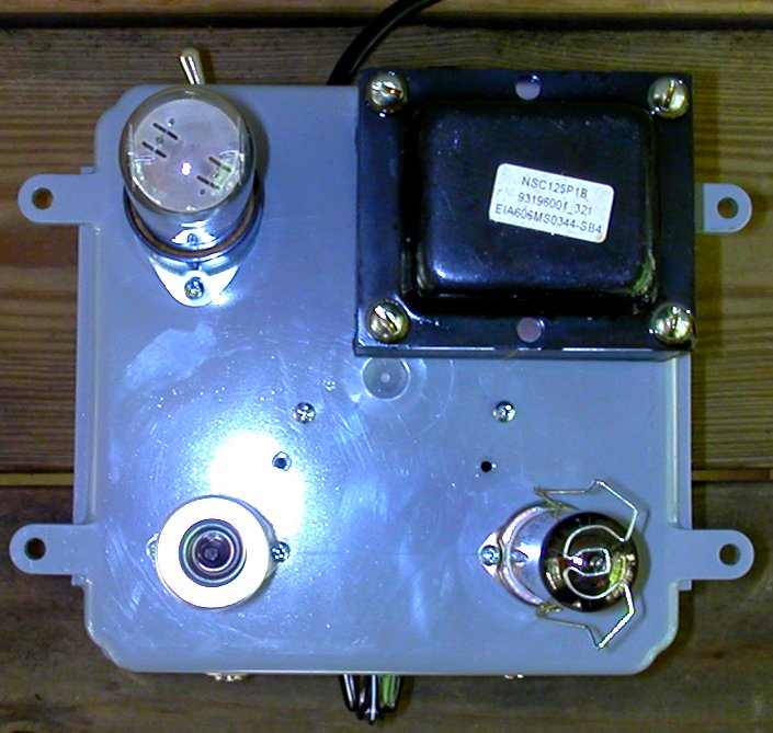

The top view: Upper left is a 5V4 rectifier tube. Upper right is a 125P1B power transformer as used in Champ's and Princeton's. Lower left is a 12AX7EH. Lower right is a EL84 power tube. The four tabs that you can see on the left and right are for mounting this box to a wall. I think I am going to bend some aluminum grating and make a cage that fits over the top and screws down to those four tabs.

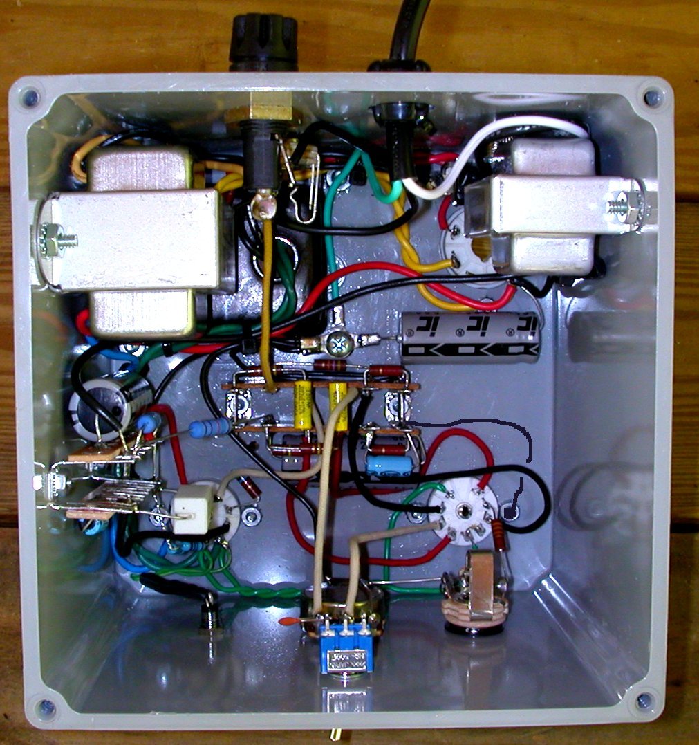

Inside View: This amp is variation of the Gibson GA-5 circuit. There are so few parts to a Champ/Gibson GA-5 type amp that I decided to just use two terminal strip assemblies to mount all the parts. I opted to use a 125C3A fender choke (upper right) instead of a power resistor. The output tranny is a 022905 Fender champ output (Upper left).
Note that since this is a PVC case, all components are isolated and not grounded. You have to ground everything that needs to be grounded with a wire. In the photo above I have added a black ground wire/line on the pre-amp tube in the lower right corner. This is so that the shield on the socket is actually grounded and acts like a shield. Use a #4 ring terminal to bolt the wire down to the tube socket mounting nut. Solder the other end to a ground point.
