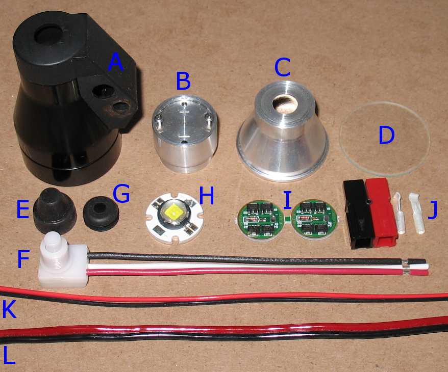

Parts list #2 for Marwi SSC P7 conversion
This is a parts list for the dual 1400ma board type drivers that I currently build
Note that I do not show the top copper circuit board in this list
I may sell this board at a later date, but not right now.
Click on the image for a larger image
Parts List for Marwi to SSC P7 conversions
A - Marwi old style light body
B - Marwi SSC P7 heat sink with 2 mounting screws
C - 35mm machined reflector
D - 34.8mm glass lens
E - Rubber boot for Judco switch
F - Judco SPDT switch
G - 5/16" grommet
H - SSC P7 LED
I - Two 1400ma current limiter boards
J - One set of Anderson PowerPole connectors
K - One Foot each Black and Red Teflon wire
(You only need a couple inches of each color. You will have some extra for your next project)
L - Three feet of Red/Black 18 gauge Zip Wire
Not shown in picture
A short piece of 22ga solid core to connect the boards together
A small piece of 1/4" diameter heat shrink for the power wire
You may also need a Marwi Helmet or Handlebar mount and the nylon Marwi mounting kit.
This list does not include batteries or chargers.
