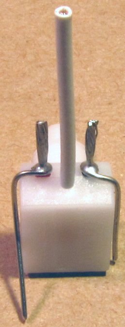

SPDT Judco switch and two 1400ma current limiter boards

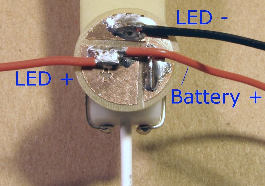

Here's a shot of the 1400 ma current limiter boards I use on the assembled Marwi P7 lights
These boards are machined on my CNC machine so that wires can pass through the boards when they stacked up on top of each other.

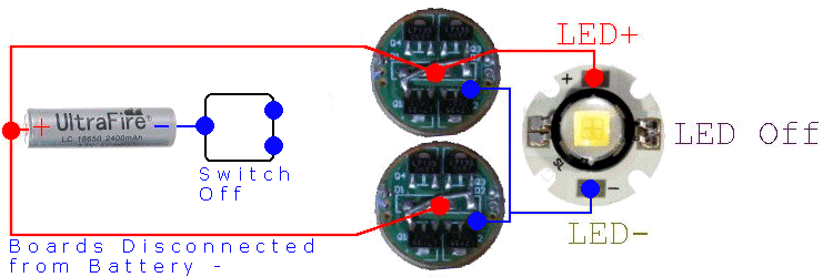

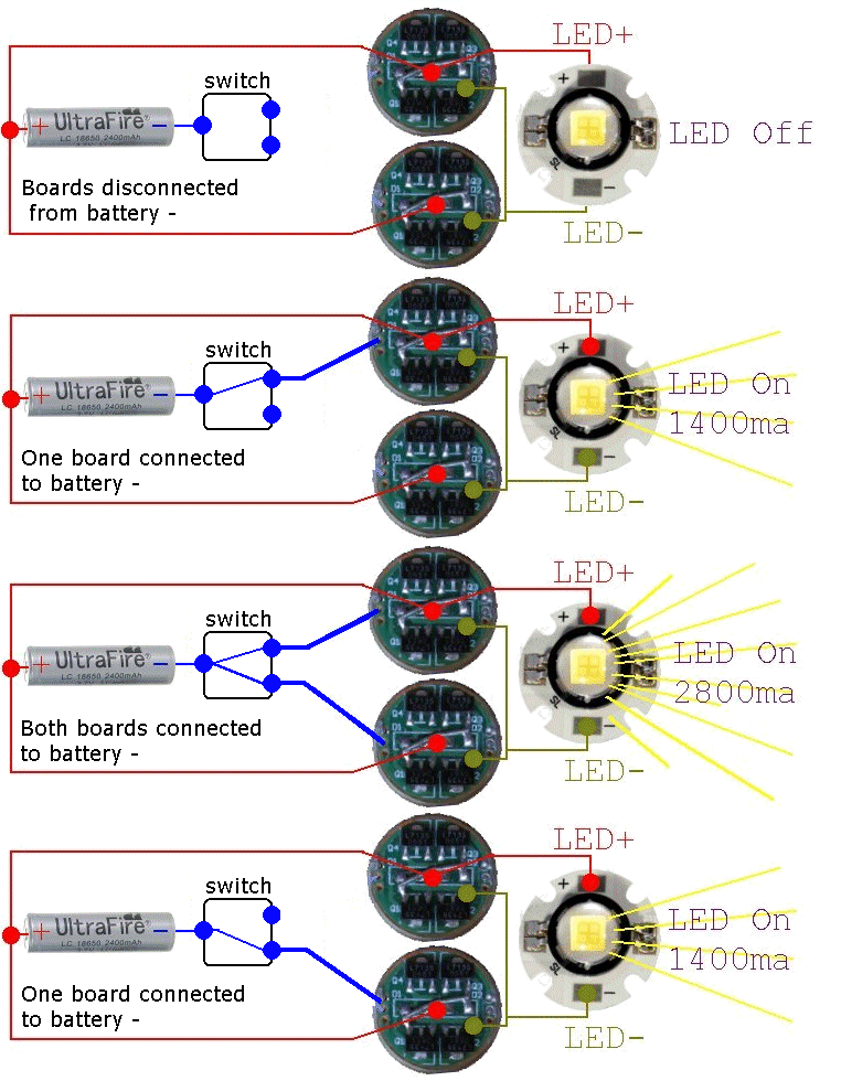

This diagram describes the SPDT Judco switch switching and how it works with the dual 1400ma current limiter boards.
OFF - When the switch is off, the battery negative is disconnected from both boards and so the LED is off
LOW MODE - When the switch is on the Low mode, it connects the battery negative to one of the 1400ma current limiter boards.
This limits the LED current to 1400ma giving you a low power mode.
High MODE - When the switch is on the High mode, it connects the battery negative to both 1400ma current limiter boards
This limits the LED current to 2800ma giving you a High power mode.

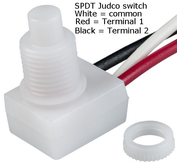

Note that the SPDT Judco switch actually has 4 click positions.
(OFF) - (ON1 = low) - (ON1 & ON 2 = High) - (ON2 = low)
There are actually two low modes and one high mode because of the way this switch works internally
Each low mode just turns on one board. They are both the same, 1400ma of current limiting

The Judco switches I use are USA made push button switches that are very high quality.
I am using Rubber switch boots that waterproof the switch plunger on the Judco switches

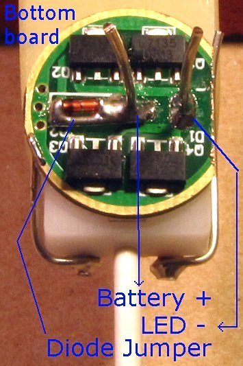

You do not have to solder the jumper wire across the diodes.
I do it because I do not trust the tiny surface mount diodes and I also want to eliminate the small voltage drop across the diodes.
If a diode fails, the board will stop working and so I jumper across them to take them out of the circuit.
Each 7135 chip regulates 350 milliamps of current and so 350ma x 4 in parallel = 1400ma total
The diode is on the board for protection in case you hook up your battery backwards.

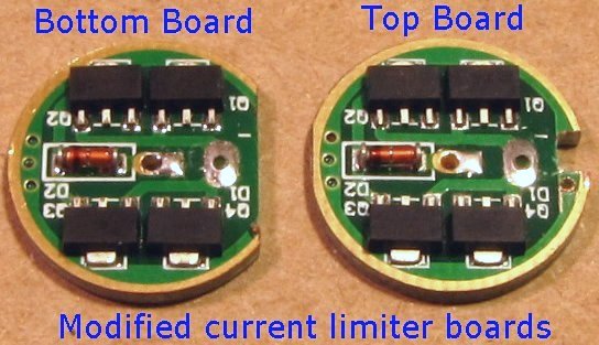

If you have some fabrications skills, you can alter the stock current limiter boards that I sell and make this driver assembly
 You can machine the boards with a Dremel tool rasp bit
The bottom board has one side removed so that a wire can pass by the board and go up to the top board
The top board has a notch so that the Battery + wire can exit out the bottom of the heat sink and go to the power cord.
Both boards have all the gold removed around the LED Minus hole on the back of the board
This prevents the LED - wire from shorting out to the Battery + area on the back of the board.
The LED - holes that pass through each board can be drilled with a 1/32" drill bit
See the board mod tip below.

Board mod tip
image -

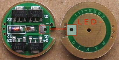

The center gold area on the back of the boards is the Battery + and LED +
The outer gold ring is the battery negative connection
You do not want the LED negative wire to contact the center gold area on the back of the boards.
Remove the gold area around the LED negative hole on the back of the boards with a Dremel.
The board on the right above shows how I removed all the gold around the back of the hole with my Dremel.
This is the Judco SPDT switch These are the modified 1400ma current limiter boards
See the board mod tip above about the backs of each board

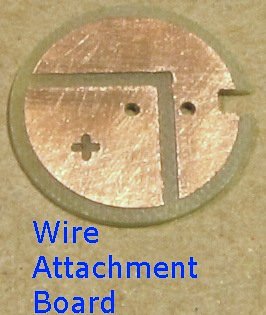

I also use a small circuit board that is the
 attachment point for the LED wires and the Battery + wire

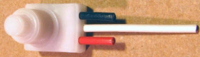

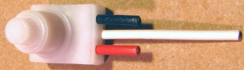

Trim the switch wire lengths and remove the Red and Black jacket
The white wire should be left about 1.5" for now
See the images below
Space is tight inside the Marwi housing.

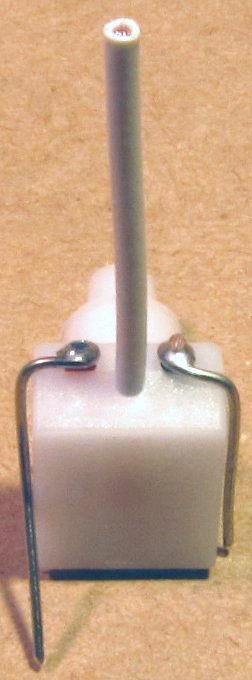

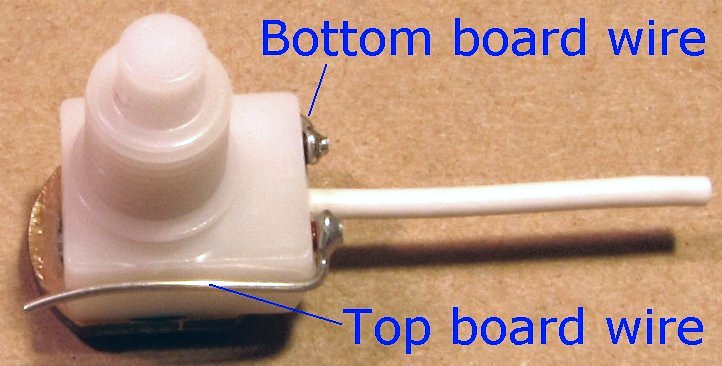

You need to reduce the size of the 18 gauge black and red switch wires.
These two wires go to the battery negative on each current limiter board and cannot be a large diameter wire.
Remove the red and black wire insulation all the way down to the switch body.

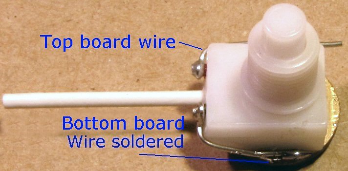

Solder some 20 gauge solid core buss wire to each 18 gauge wire and bend them around the switch body as shown above.
Snip the extra 18 gauge wire off right above your solder joint

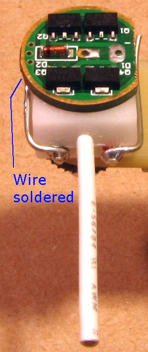

Super glue the bottom board to the back of the switch to hold it in place
Solder the bottom board negative wire to the edge of the board.
This shot shows the opposite side of the switch
 Another shot showing the bottom board.
The battery negative wire is soldered to the bottom board.

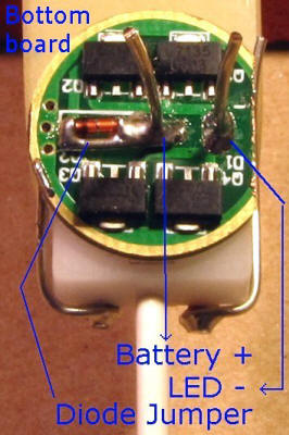

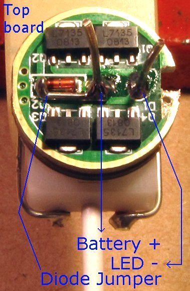

 Add 3 wires to the bottom board
Wire 1 = The Battery + wire
Wire 2 = The LED - wire
Wire 3 = A short jumper across the diode
Solder all 3 wires in place

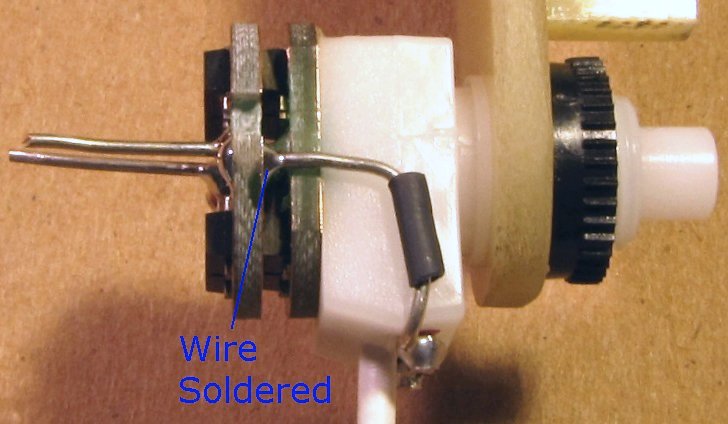

Slide the top board down onto the stack.
Solder the base of each wire
Add a diode jumper to the board
A side view of the whole stack

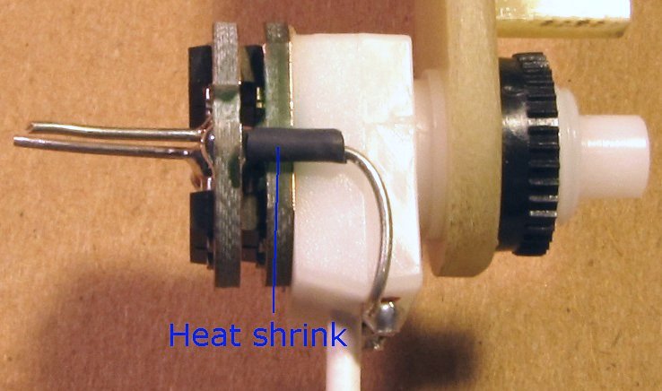

Add a piece of heat shrink to the top board negative wire
Bend the wire and solder the wire to the top board ground
Slide the heat shrink up so the top board wire
cannot short out on the edge of the bottom board

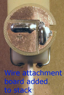

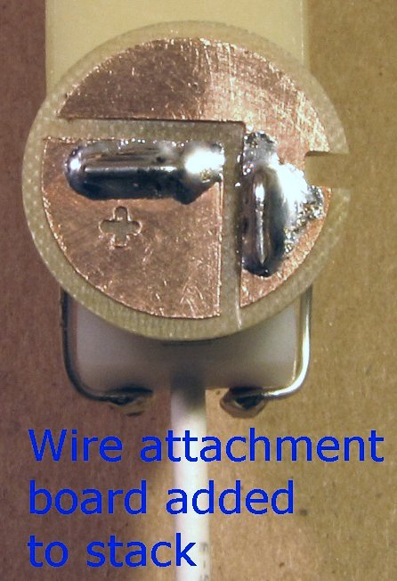

Slide the wire attachment board onto the stack
Bend the wires over, trim them to length and solder them
The outer diameter of this board fits inside the heat sink and keep things centered
I have soldered 3 Teflon wires to the attachment board.
The Red LED+ wire,  The Black LED- wire, and the Red Battery + wire
The Battery + wire goes over and down through the notch
 so that the heat sink can slide down onto the whole stack.

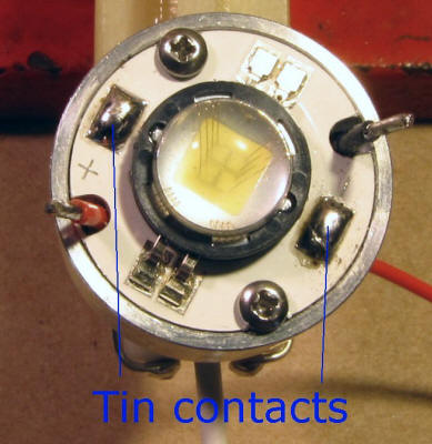

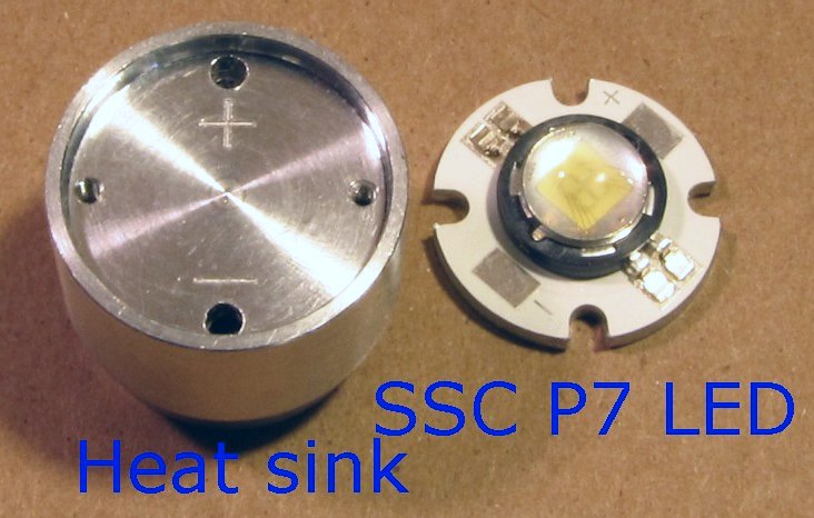

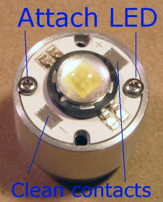

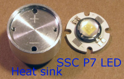

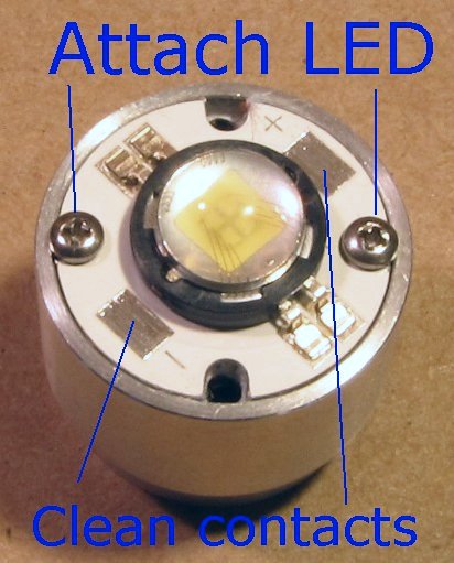

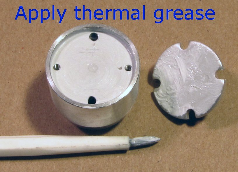

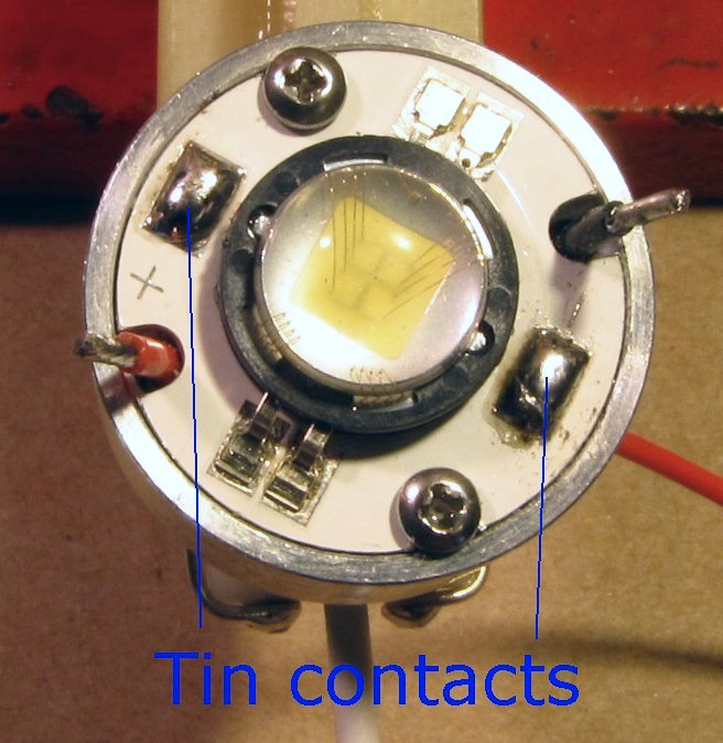

The heat sink and SSC P7 LED Apply thermal grease to each surface
Screw down the LED to the heat sink
The contacts have some sort of clear coating
Use an Exacto knife to clean the coating off the solder contacts

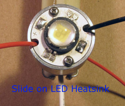

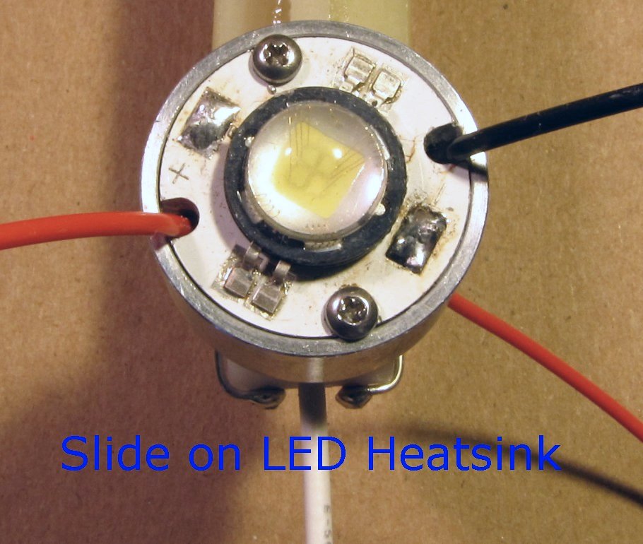

Slide the heat sink down onto the stack

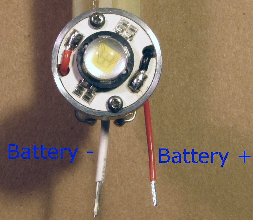

Red wire is LED +
Black wire is LED -

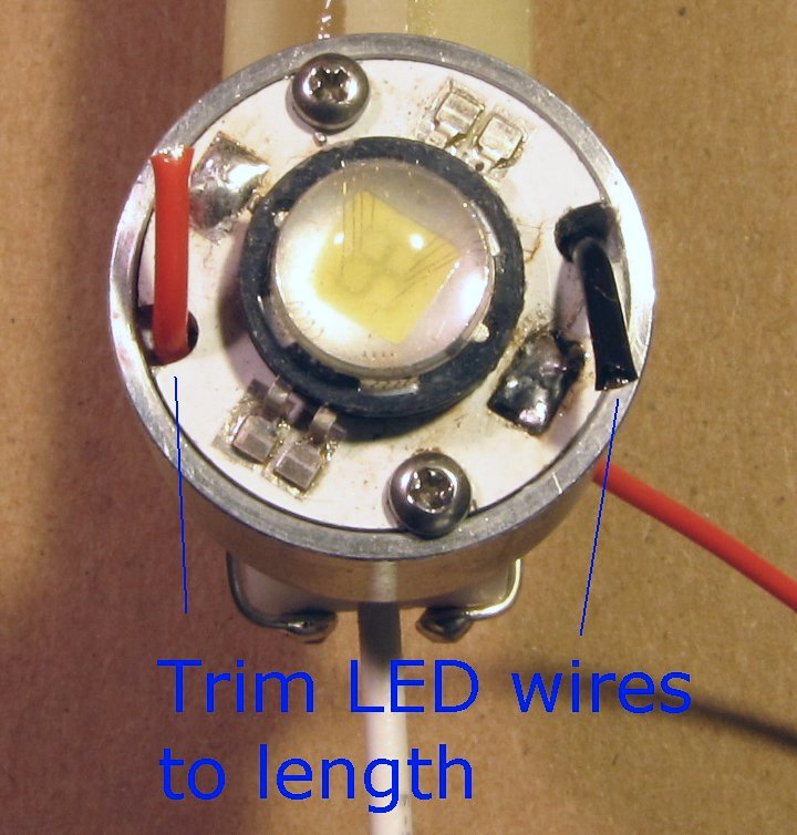

Trim the wires to the proper length Strip the wire ends and tin the ends with solder

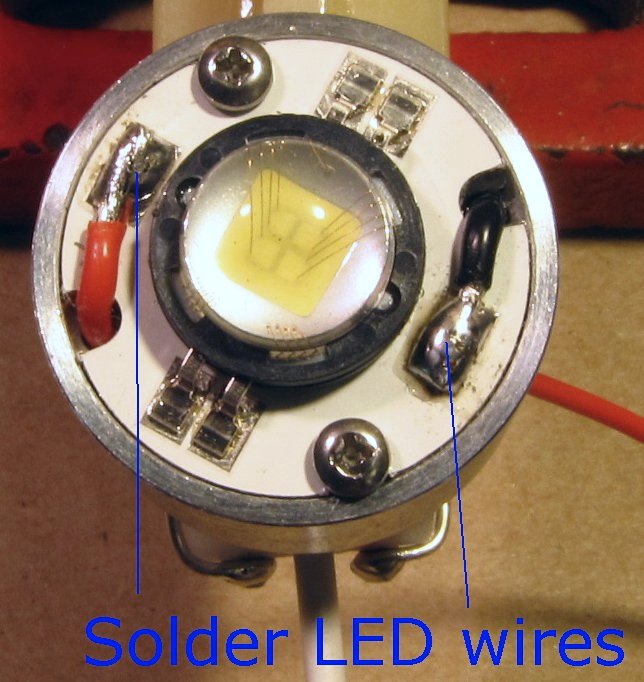

Add a bit of solder to the LED contacts
Solder the LED wires to the contact points
I do this with a 40 watt pencil soldering iron
A small wattage soldering iron will not do this properly

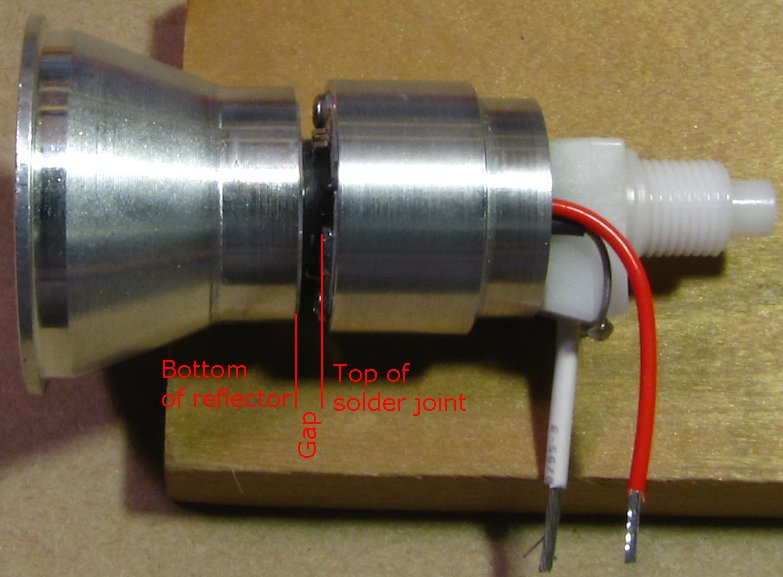

Above Left: This picture illustrates how important it is to keep your LED solder joints as low as possible when soldering the LED + and - wires to the connection points.
If you blob a bunch of solder onto the solder joints, and the solder joints stick up too high, it is possible to short out the LED connections on the rear of the metal reflector.

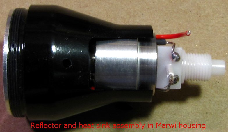

Above Right: This picture shows how the heat sink assembly fits into the Marwi housing.
Note that I have to resize the housing so that the heat sink fits very snugly into the housing.
I have a tool that squeezes the rear housing down just a bit to make the heat sink a very tight fit.
I want maximum contact area so the heat is drawn away from the heat sink and out to the Marwi housing.
