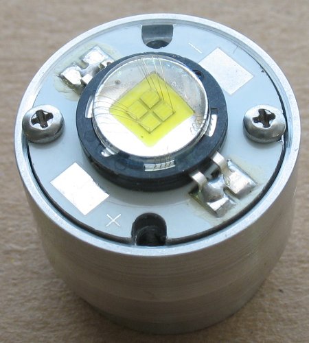

This page shows an older hand made LED capsule
that I made on my lathe. I now stock a Marwi heat sink that is much nicer. |
| Click on the images for a larger image | |

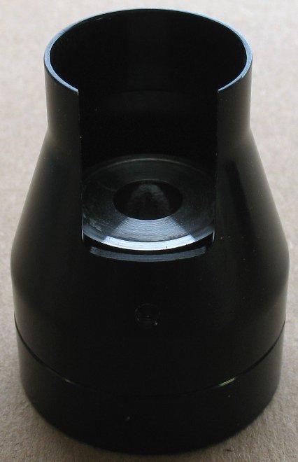

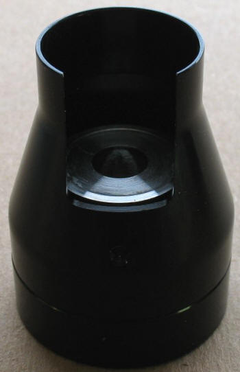

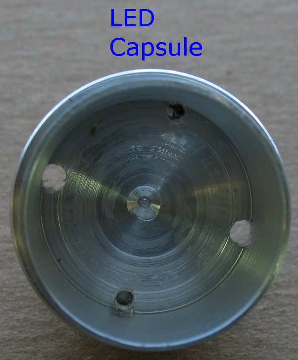

This is what the aluminum LED capsule looks like. The SSC P7 LED sits down inside a recess and is screwed down to the capsule. The LED capsule is bored out hollow. The LED contact area behind the LED is about .1" or 2.54mm thick The outer diameter of the LED capsule is in contact with the Marwi body. The heat is transferred from the LED capsule, out to the body and is dissipated by the Marwi aluminum light body. |

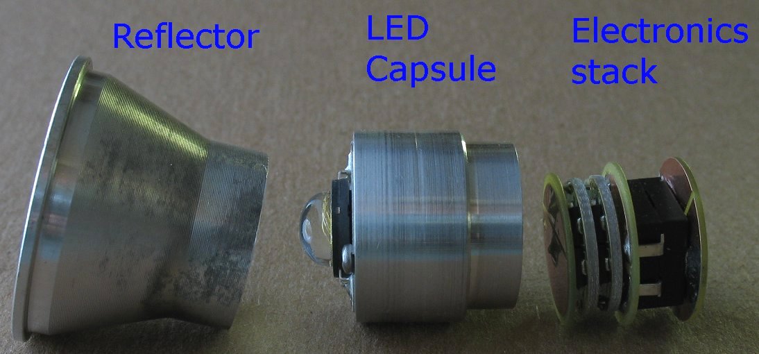

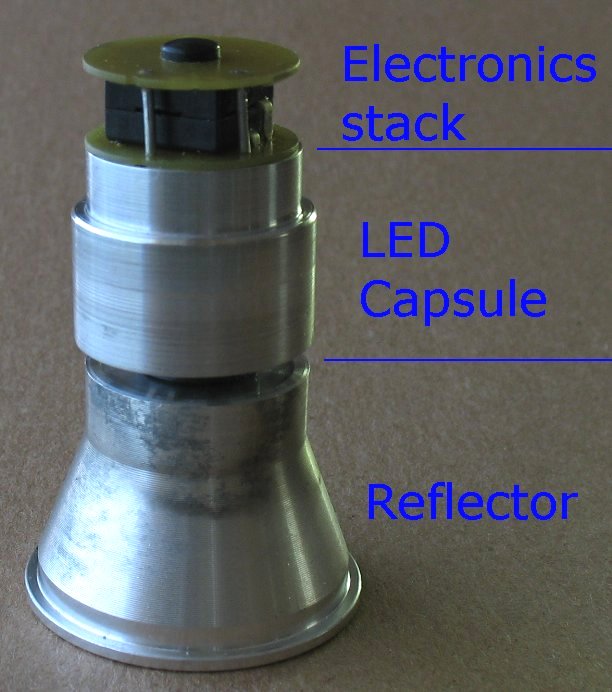

This shot shows the 3 assemblies that are inside a Marwi body The Reflector, the LED capsule and the electronics stack. Note the smaller diameter circuit boards on the left side of the electronics stack. This section of the stack fits down inside the LED capsule. |

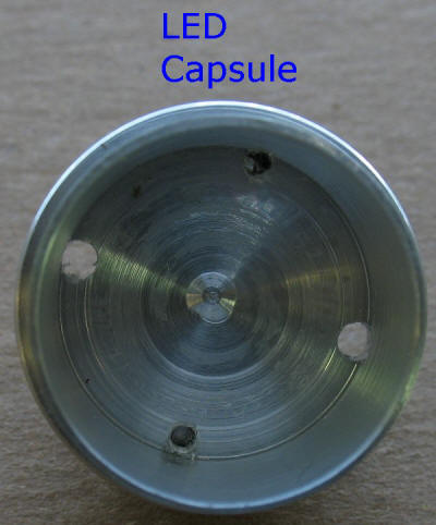

| This shot shows how the whole stack fits together. | |
Part of the electronics stack sits down inside the LED capsule. The part inside the capsule is about the same diameter as the inside of the capsule. This keeps the stack from shifting around and centers the stack inside the capsule. The circuit board under the switch is wider than the boards inside the capsule. This board is the same diameter as the rear rim of the LED capsule and sits flush against the back rim of the LED capsule. When you press the switch, the whole electronics stack stays centered and firm against the capsule. The SSC P7 LED lens fits down into the hole on the reflector |

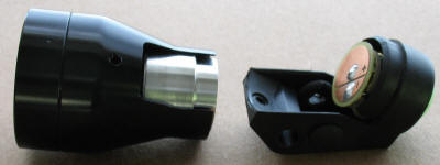

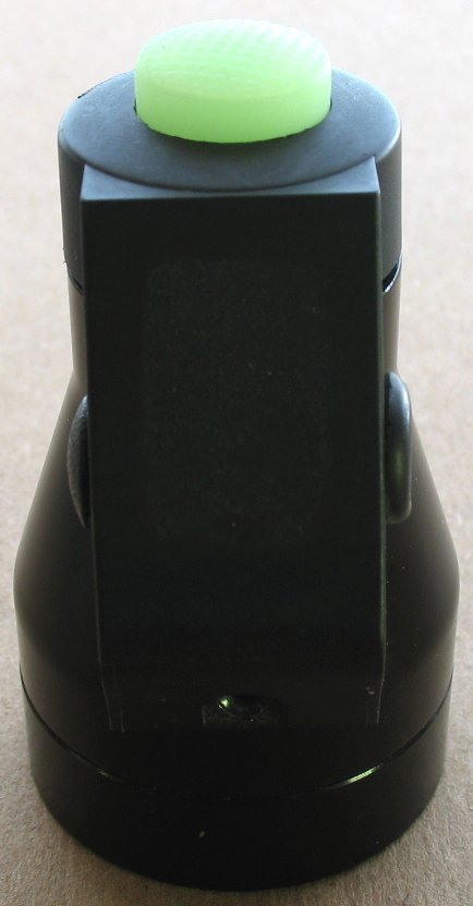

This shot shows how the Marwi body mates up with the rear
switch/mount section. The hole at the bottom of the plastic section is where you bolt on the Marwi helmet and handle bars mounts. |

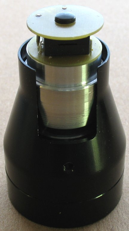

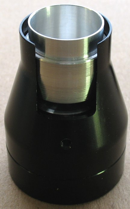

| Here's a shot of the back of the reflector as it sits inside the Marwi body. |
The LED capsule fits snug inside the body and sits on top of the
reflector. Note how the LED capsule is in contact with the Marwi body. This lets it transfer the heat from the LED to the body |

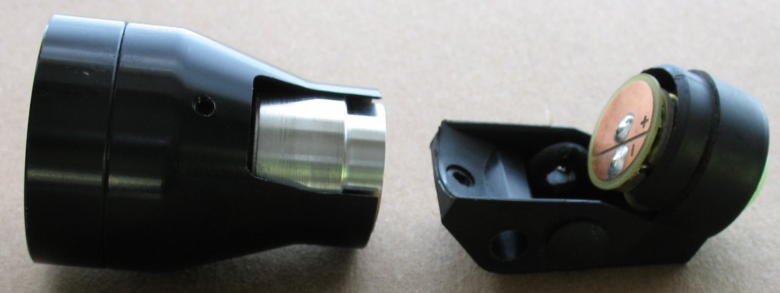

Part of the electronics stack sits down inside the LED capsule. The switch board keeps the electronics stack from being able to be pushed down into the capsule. |
The rear section of the light goes on the body and is held in place by a screw. |

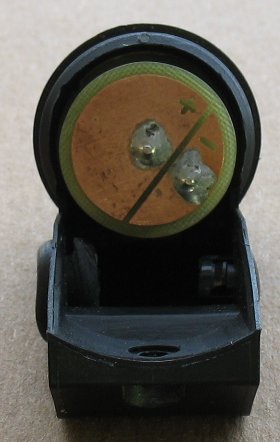

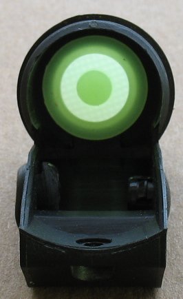

Here you can see down inside the rear section of the Marwi light. Note that I have machined the hole larger so that I can use a rubber tail cap. The Marwi lights come with a SPST Judco switch that uses a much small hole. |
Here's a shot of the electronics stack sitting down inside the rear section. |
