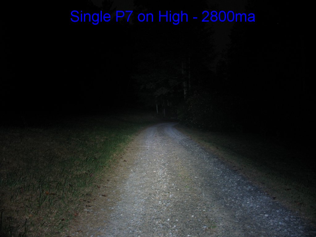

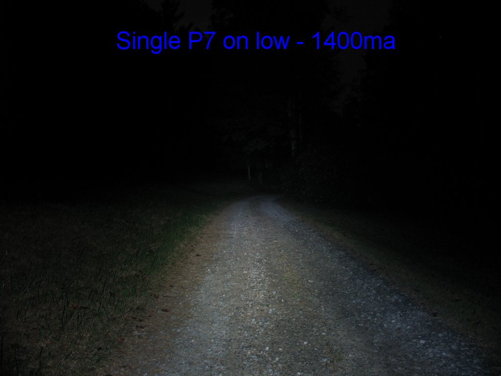

Just for a comparison, I took one of my Marwi P7 lights along for beam shots of the Triple P7
The single P7 Marwi has two modes, 1400ma = Low and 2800 ma current = High

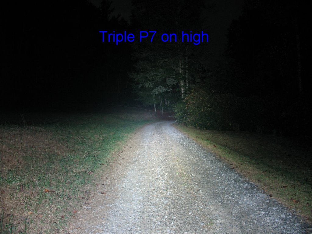

The Triple P7 only has one mode, and that is full on, direct drive off of a 3.6volt 7 x 18650 battery pack.

That skinny cluster of trees on the left side of the road after the road bend is 150 feet away from the camera

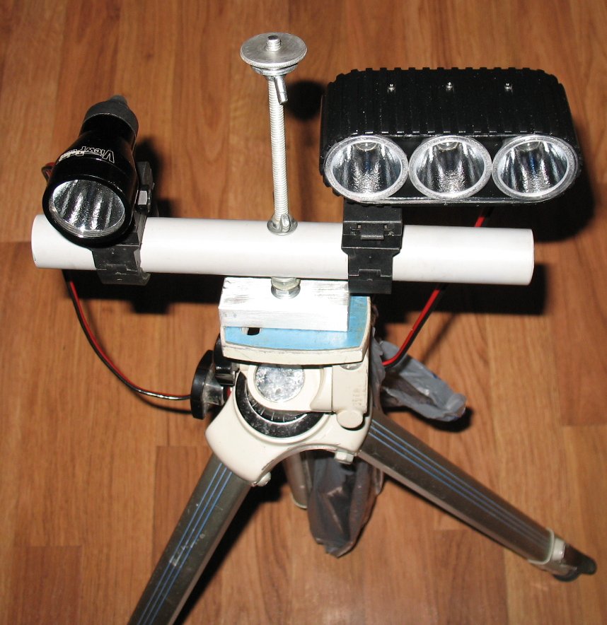

Here's a shot of both lights and my Tripod mounted Beam shot rig
The camera sits at the top of the threaded rod, above the lights
My Marwi single P7 light on Low = 1400ma current
My Marwi single P7 light on High = 2800ma current
My Triple P7 running full blast
This is what I will be running on my handle bars this season :)
