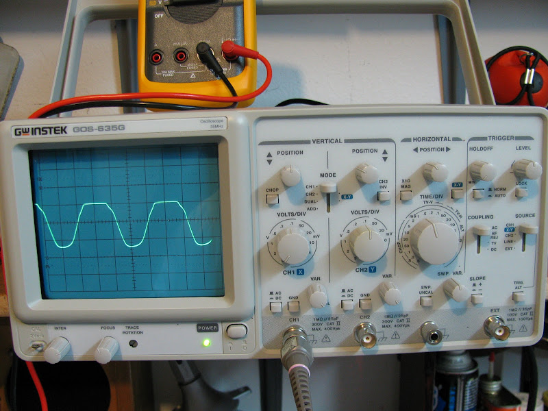

...is it normal for the the square wave in a analog scope not to have any vertical lines in the trace? The first picture is with the probe at the calibration notch on the scope. The second is with the BK 3001 signal generator at 1k square wave. The third is the bk 3001 1k sine wave. thanks for any advice and most of all everybody's tolerance to my questions.
[img width= height=]http://lh5.ggpht.com/_yFex0loOVcw/S8ztG9LJURI/AAAAAAAAAcI/3o5ruiWfWzc/s800/IMG_0496.JPG[/img]

That square wave is totally normal.  There are vertical lines, but they are very very faint.  This is normal.
Yes. Well, there really are vertical lines but your time/div is so slow you can't see them. Your time/div (AKA horizontal sweep speed) is set to 2 ms which is too slow to measure anything on that particular square wave. Turn the time/div clockwise (faster) until you are displaying only one or two cycles of the square wave. Then the vertical trace will be more visible. You'll also be able to measure the time of one cycle (and freq = 1/time). In fact, you can speed it up enough to actually see that the vertical line has a slope to it. This slope is called risetime on the positive slope and falltime on the negative slope. Risetime doesn't mean much in the audio world but it's very important in the radar world.
Take it slow and remember, a scope has two main functions... measure amplitude (vertical) and measure time (horizontal). In fact, your display is a graph that plots voltage and time.
If the square-wave were PERFECT, the rise happens in ZERO time, so there is zero mark on the screen.
Even the imperfect square from a $1 calibrator will rise in very-small time and leave very-little trace. Absolutely normal.
What Sluckey said: Turn your sweep to get less than 20 cycles on the screen. One or two full cycles is often good. If you still have "invisible rise", then get one at the center of the screen. Hit your "Horiz X10 Mag" button, twist the H.Pos knob until the fractional trace jumps from top to bottom (a rise section). Now dial-up the brightness "INTEN". You'll probably see a faint rise.
If that still won't show the rise: put a 0.1uFd cap across the calibrator output. That will give slanty-waves with full trace. Now try 0.01u, 0.001u, 270pFd.... it gets less slanty and more square. With smaller loading-caps the rise goes up faster and fainter.
Now put your X10 back to normal (it's not much use in audio! this isn't radar) and dial the INTEN down till the trace fades-out, then up just until it shows well (excess brightness is not good).

Awesome, thanks for all the great and educational responses! That's what makes this board so great. You guys put my mind at ease, i thought something was wrong.

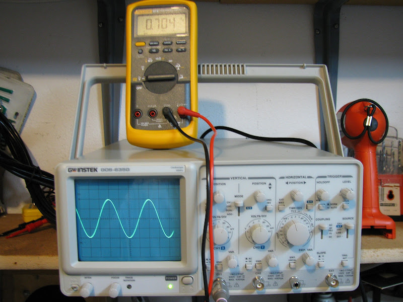

Ok, I am confused. Please educate me  :grin: I followed your instructions the best that i could, I am still learning so I confuse things alot. I set everything as you said (i think, the picture should clarify if i wrong) but my meter says the sig gen is putting out 0.7v. According to the procedure you just typed out it should be at 200mv, am i miss understanding something? BTW what does Vpp and Vp mean?

Vp - means "voltage peak" - measure from zero to the top of the waveform
Vpp - means "voltage peak to peak" - measure from the lowest part of the wave to the highest part.
Your Fluke meter on AC will measure RMS. which is about 0.7 the size of Vp.
Looking at your scope I think it say the vertical is at  50mV/div,  so the Vp is 100mV and the Vpp is 200mV
What is confusing me is your meter.  If your fluke meter was reading the true RMS of the wave, it should read about 0.070V.  So why is it reading 0.700V?  I think it is because the frequency is at 500Hz and that is goofing with the meter.  ANyways, I will now let PRR or sluckey correct my thinking.
  • Posts: 5377
You set it up perfectly and everything is in agreement. The only confusion factor is that the Fluke 87 measures true RMS and the scope displays peak to peak. One other confusion factor is that you're using a 10:1 probe. Soooo....
The Fluke reads .7VAC. (I trust the Fluke over that scope any day)
The scope reads 200mVpp which is 100mVpk. But.... you're using a 10:1 probe, so the scope is really measuring 2Vpp or 1Vpk.
The voltage conversion factor for a sine wave is Vrms = Vpk x .707.
This means that your scope and your Fluke agree with each other. You're good to go.
When using the scope you need to train yourself to think in terms of peak to peak voltage. When using the Fluke, you need to think in terms of RMS (root/mean/squared) voltage. And you need to always be aware of the relationship between VACrms and VACpp when dealing with sine wave signals.

ahhh 10:1 probe - that explains it!

ok, i'm still trying to figure things out. I understand that x-axis is voltage and we set the scope for 200mv peak to peak. I don't understand how the number .7 comes about. If the y-axis is time, then how do we get 100vp from 0 to the top of the wave form. I though it was time not voltage. Another thing how does 100vp = 0.7v I am very confused. Can someone explain this or point me to a link that might explain this to me. Thanks for your patients guys.
Offline tubesornothing
  • Posts: 2664
X axis is TIME.  Y axis is VOLTAGE.  Measuring from the horizontal 0 volt line to the top of the wave form is along the vertical Y axis - voltage.
First thing is you have your probe switched to 10x so what you are seeing on the screen is actually 1/10th of the voltage.  So if you have your probe turned to 1X (make sure to readjust your vertical to 0.5V/div) you will see the wave form will be 1V peak (or 2V peak-peak)
#2 your DMM does not measure peak AC voltage, it measures RMS AC voltage.  So its not going to measure the 1V peak.  RMS value of 1V peak is about 0.7V.  (read the link sluckey posted for a proper explanation of RMS).

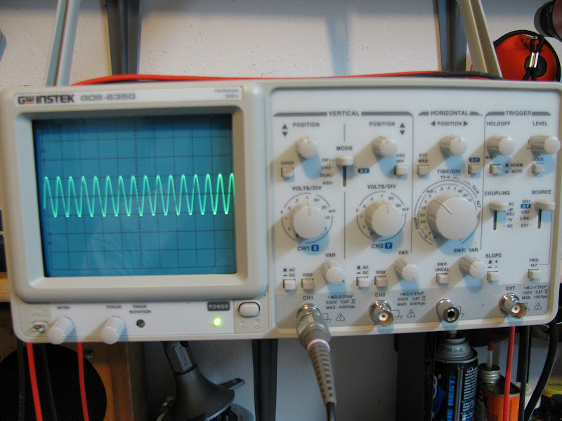

Ok, I was finally able to get around to my homework assignment, thanks tubesornothing  :grin: The first pictures show the sig gen setup how sluckly guided me to except the signal is going though the amp and being measured on the grid(pin 2) of v1. The  result, it looks exactly like it did before. I guess this makes since because its the same signal except traveling thought the guitar cable. Was this what i was suppose to do?
Well my first assignment wasn't very exciting so i decided i wanted to try something else. I attached the probe to the control grid of the 6v6 on my aa764 champ. The result is depicted below. It doesn't look as i was expecting, I was expecting a little more uniformity in the clipping (right or wrong?) Is this what its suppose to look like? Volume was on 10, all the way up.

That looks just great to me!
Tube gain stages distort asymmetrically.  Saturation will be a soft rounded distortion, whereas cut-off will chop off the wave form.  Each gain stage flips the wave (except for CF).  This is the beauty of tubes.
Here is an article on saturation and cut-off distortion: http://www.guitarnuts.com/amps/g40v/index.php
CAUTION:  dont hook your scope directly to a plate or any high voltage source.  You will fry the scope.  If you want to see the signal after the plate, make sure it is after the coupling cap.

Your 'scope on 6V6 grid with BIG signal is correct. The 5-watt amplifier is attempting to put out 10W or 20W, and can't.
If you wanted a clean sound, you would play softer (try 20mV to input) and turn-down (try "5" on the volume control). Now the output should be very much like the input, only bigger, and (at the OT secondary) able to pull a heavy load (8 ohms).
