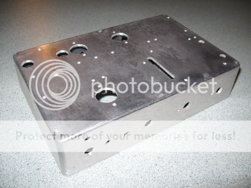

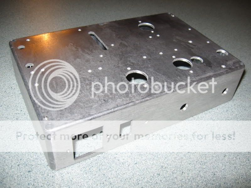

On with the chassis bashing...
The first construction step was to prepare the chassis layout. Good practice is to keep preamp stages away from both the power supply and the output stage. To achieve this, the power transformer was placed at one end of the chassis, the output transformer at the opposite back corner and the preamp valve at the front, very close to the input socket.
The top of the chassis was marked out for the transformers, the valve sockets, holes for transformer leads and mounting points for tagstrips.
Once the chassis layout was marked out (and carefully checked!) a centre punch was used to accurately locate points to be drilled.
The centre-punch points were deepened with a 1.5mm drill so the larger drills to be used later in the process would centre correctly.
Front panel holes were required for:
                                                Power LED
                                                Input socket
                                                Gain switch
                                                Bright switch
                                                Volume, Tone and Master potentiometers
Rear panel holes required were:
                                                IEC power input socket with integrated fuseholder
                                                Power switch
                                                Line out socket
                                                Speaker socket
Once the layout was complete, serious drilling could begin. The old carpenter's maxim of "measure twice, cut once" also applies to metalwork. Drilling was done using a drill press but a hand drill could have been used. The holes were drilled in sequence, starting with the smallest diameter and moving up to larger sizes - far better to mistakenly drill a hole too small than too large. A chassis punch could have been used for the valve socket holes although the one available would probably have hurt itself attempting to punch 3.4mm diecast. The valve socket holes were finally cut using a step drill - one slight error being caused by the valve sockets being 19mm, while the step drill's steps were 18mm and 20mm.
The holes where output transformer leads would pass through the chassis were drilled large enough for protective rubber grommets to be fitted. Large irregular-shaped holes for the IEC connector and power switch were produced by drilling a string of closely spaced smaller holes and joining them up by GENTLY rocking the drill or chassis from side to side. (My metalwork teacher was spinning in his grave when I typed this...) An assortment of round, flat and triangular files were then used for smoothing and deburring hole edges.
Once the chassis bashing was complete, the chassis was cleaned and the marking out lines removed.
More to come...

I love how you call making the cutouts and holes 'bashing'. Aussie's are hilarious!
 Nice work by the way!
 Save yourself some drilling when making square holes:I use a large drill bit in each corner of a square hole and then use a jig saw with a metal blade to cut it out.Takes seconds on aluminum.Any touch up can be done with a flat file.
Often my metalworking could be described as an act of violence against an unsuspecting chassis. It also generally includes a degree of self-harm. A point for discussion - should blood spilled during the construction of an amplifier be left in situ, to add to the amp's mojo? :icon_scratch:
Thanks for the tip on the jig saw. :icon_thumright:

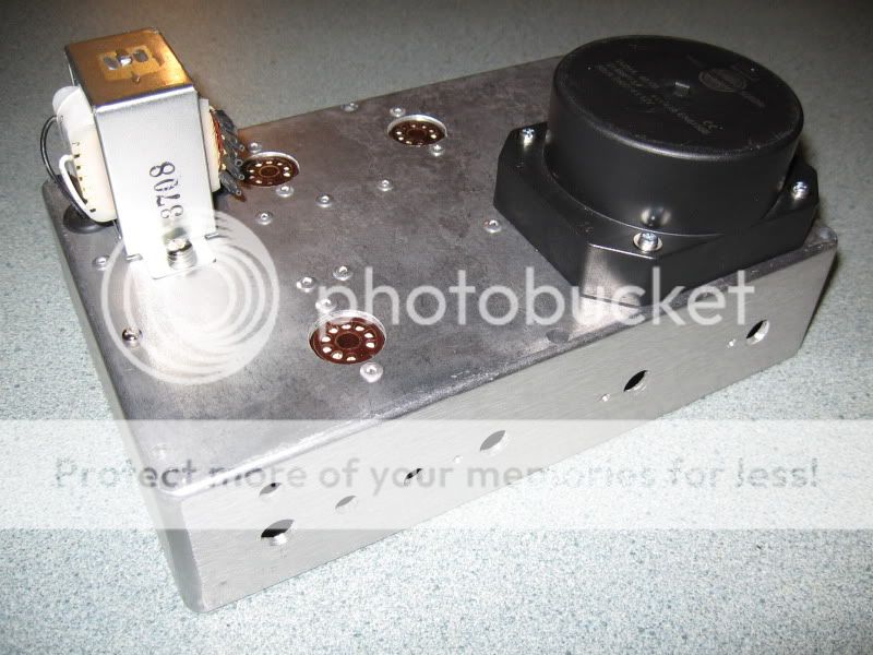

On with the construction:
The first step was to fit rubber grommets where leads would pass through the chassis, and then to rivet the valve sockets in place. The tagstrips were then riveted in place. A riveted tag can not be used as a reliable earth connector so the earth tags at the end of each row were bolted down using a machine screw and nut, with a star washer between the tag and chassis and another star washer between the tag and nut. 18-gauge tinned copper wire was then run beneath the tagstrips and soldered to each earth tag. These tags could then be considered reliable earth points. This "earth plane" construction is at variance with the conventional wisdom regarding star earthing but in this layout it does not introduce unwanted noise or instability.
Next was the power transformer - a fully encapsulated toroid, originally intended for mounting on a printed circuit board. Standard practice for toroidal transformers is to mount them with a large single bolt through the centre of the toroid. In this amplifier the single bolt mounting was not suitable, because even a small amount of free movement would have caused the transformer terminals to short circuit against the chassis. Fortunately the transformer designers must have had this possibility in mind, because there was an alternative mounting arrangement available, using four smaller diameter bolts.
The output transformer was also installed at this stage. Exposed tags on the primary side of the transformer were shrouded with heatshrink tubing before the transformer was mounted, and its leads passed through the chassis. Twisted pair heater wiring was run from one 12-volt secondary of the power transformer to the three valve sockets. The optimum heater voltage is 12.6 volts, but 12 volts was considered to be within an acceptable tolerance.
The IEC power connector was riveted into the chassis, and a lead run from its earth pin to a bolted down chassis lug. Next 240VAC power wiring was run between the IEC connector, the power switch and the power transformer. Heatshrink was used to cover exposed terminals.
Most of the power supply components were now installed. This power supply is a voltage quadrupler, so there are four diodes and four electrolytic capacitors in the B+ supply. Three additional power supply nodes were required for the output valve screens, the phase splitter and the preamp stages - these were installed as the other small components were being added to each stage. The large radial lead electrolytic capacitors were lightly glued in place with some contact adhesive, to reduce stress on their mounting leads.
Two 120 ohm 1 watt hum balancing resistors were fitted from each side of the 12-volt heater supply to earth. One potentiometer had to be fitted before the electrolytic capacitor immediately behind it was installed. This can not be considered good layout.    It will be corrected in the Mk II version of this amplifier... :rolleyes:
Still more to come...
Really interesting approach, and this proves that any grounding scheme is fine - provided it works :wink:
Did you do something with the PT terminals to shield them from the edges of the long, skinny access hole?
Thanks for the detailed blow-by-blow with pics.
The limited clearance was the prime motivation for using four mounting bolts on the power transformer. A single bolt through the centre of the toroid would have left the transformer free to rotate, causing the terminals to short against the chassis. I have used heatshrink to completely cover the 240 volt primary connections, but I haven't taken any extra precautions on the secondary side. I don't think the transformer is going to move, unless subjected to extreme violence. Now you have asked the question, I will give it more thought...
