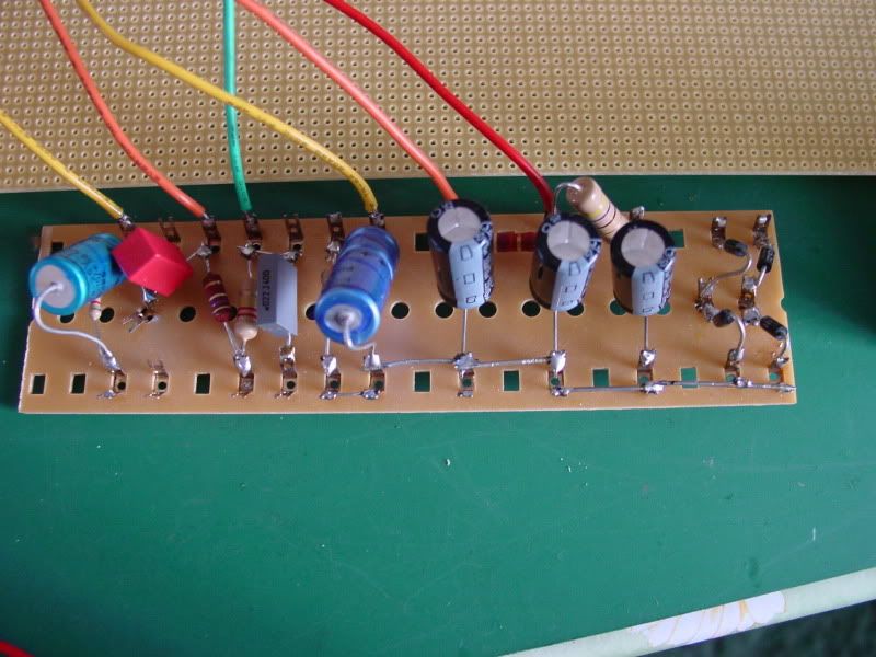

Offline rumble
  • Posts: 24
Re: Rumble's 1/3rd watter
« Reply #5 on: May 23, 2009, 02:07:02 am »
Hi Rumble. I drew that layout. There is a missing wire at the V1 plate resistor. That one goes from where the two resistors meet in a V to the positive of the nearest 10uf filter cap.
@7string, is it possible for you to draw the missing wire on to the layout, that is standing here?

  • Posts: 5394
« Reply #6 on: May 23, 2009, 12:40:18 pm »
Here's the missing wire...
Offline rumble
  • Posts: 24
« Reply #7 on: May 28, 2009, 03:06:37 am »
thank you sluckey, this would have gone terrible wrong i understood it an other way  :-[
now i only have to know witch tube is better to use, the GE ore the sovtek, than i can start ordering

Offline rumble
  • Posts: 24
« Reply #21 on: June 16, 2009, 03:36:04 pm »
it is not a lot but some parts are in
chickenheads, tube's 1 transformer and a 8 inch Tube Town speaker
and i have added the missing wire and i hope i have got the right spot for the bleeder cap

i know i know, it took long again but the weather was that good that i had to work on my guitar-builds first because the woodwork had to be done outside.
but working this schematic out
and it looks like this now
because i did not wanted to get shorts i used a board to lay on the bottom of the metal case
the i mounted the complete board on top of it with in the middle a little bold that goos through both boards to fixate them.
so now i have to make the top of this metal case holding and keeping the rest of the parts like the tubes etc.

did some work again  ant it looks like this
the parts that go in/on the other side of the pc power supply part
now i have to be carefull not to 'Woe be upon he those who invert their nomenclatures!!' :grin: :wink:
