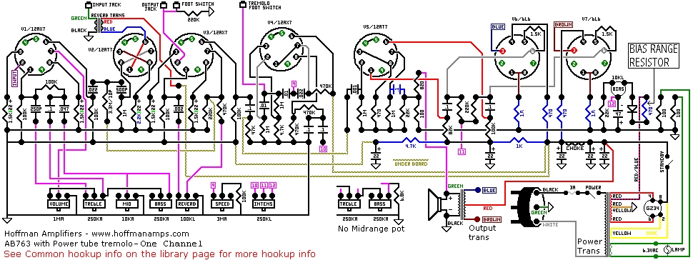

Hello all
I'm new here and I look forward to the discussion I'm hoping to engenderjavascript:void(0);
I'm building a vibrolux 5F11 using and existing Electrohome Hifi chassis as a bassis
It has a good power transformer with a seperate filiment tap for the 12AX7 (hum control..neat)
An 8 ohm nice sized under the chassis mounted output transformer
And a usable tube compliment of 2 6V6GT 5Y3GT 12AT7(driver) 12AX7 preamp and 6AV6 (preamp)
It also has an interesting feature of what looks like an adjustable bias for the 6V6 run off the 2 220k resistors on the grids to separate leads of a trim pot ..I believe their run to ground through the pot. The cathodes also hooks to the 220K resistors via 470 ohm resistors
It shares the exact same power amp section and 12AX7 hum balance control of a similar vintage Electrohome PA300 that I previously converted to a guitar amp by rewiring the inputs and preamp section. I will attempt to put the schematic of that up and a picture of the current amp but it was my attempts to do that on my ancient computer which seems to have foiled my earlier posting attempts.)
Anywho
i have a couple of questions
I mostly like 5F11 over the deluxe because of the nice tremelo and the negatice feedback with flatter response, more clean headroom and brighter sound. I am however not concerned with keeping it stock..I mostly want a cool amp that suits my needs and sound (mostly clean)
-I've read that the 6AV6 is basically half a 12AX7. Can I use it to run the tremelo, thus freeing up one side of the 12AX7 for potentially another channel, or gain stage.
-Is there a problem with leaving the hum balance control on the 12AX7 preamp?
-I guess if I want to have the neat vibrolux tremelo I likely can't keep the kind of neat adjustable 6V6 bias feature, Yes or No ?
- I wanted to put the standard fender tone stack (bass mid treble) in hooked the way it usually is with the 1 meg volume control
I know this has more insertion loss. I don't mind losing some potential distortion but will this make my amp too quiet?
the Pa300 schematic which shares the power amp section and preamp hum balance
I've built another vibrolux, and it sounds nice though it hums some at maximum volume..THis increased when I did the jiggery pokery to create the proper negative voltage for the tremelo as there is no bias tap. I used a tried and true formula I found on this site and the tremelo works great
i might post about it too
Thanks in advance

« Reply #2 on: January 06, 2014, 08:49:57 pm »
yes.
do you mean the second filament winding with a hum trim pot?  I'd use that as-is. no problem with that setup.  Fender would have done that if trim pots and extra secondary windings were free  :grin:
I would suspect you'd want another gain stage after a B/M/T tone stack.  you can always put a voltage divider after that make-up gain stage and before the gain stage that precedes the cathodyne.  that arrangement would probably work well with your clean headroom goal.

Thanks for the response, That helps a lot and gives me the green light on some things.
By voltage divider I imagine you mean potentiometer/master volume right?
I remember my engineer brother-in-law calling potentiometers voltage dividers
I managed to get the photos up by squishing them a little.
Am I right in assuming I'll have to do away with the trim pot on the grid and cathode (is it bias) of the 6V6s to incorporate the vibrolux tremelo circuit?
Yes. Your amp currently uses a fancy cathode bias circuit in the PA. You'll need to convert to fixed bias and build a negative bias supply. Since your PT has no bias tap you'll have to get the AC input from the HT winding. Just copy a Princeton bias supply circuit.
Could I make this into a AA964 blackface Princeton and achieve more clean volume?..
Sure. I can't say that it will have more clean volume though.
I tried the GZ34 in it very briefly and I seem to get the right sort of voltages
Is this transformer roulette?
Perfectly safe for the transformer.
And how do I tell what older transformers can handle?
The power tranny in this one is marked LK 588-1
Chasing that number on the PT will likely lead you down a blind alley. The best way to get an idea of what that PT can handle is to measure secondary voltages and analyze the circuit it is currently in.

Mine started as a Vibrolux 5F11 build. Then became a Princeton AA964. Now it is a AB763 Deluxe Reverb without the reverb and with a bias vary tremelo instead of the opto system. I used a turret board because Doug Hoffman had laid it out on his "Boards pages" and that was way easier than me trying to figure out how to do it using tagstrips or making an eyelet board. If you are comfortable doing point to point wiring, it could be done that way.
I used the SLuckey AB763 Lite  as my starting point (attached). I added the bias vary tremelo from Hoffman's AB763OldOneChannel layout. It uses both halves of a 12AX7 instead of the Princeton version which uses only one half. I changed the 100 ohm feedback-to-ground resistor to 47 ohm to match what Leo did with the deluxe reverb. Also changed the dropping resistors in the power supply to get the correct plate voltages for the phase inverter and preamp stages. After that, there was tweaking fun to match my tastes. Addiction maybe???

Too bad your mac can't take an Adobe Reader update. The sluckey schematic shows the wiring between the preamp and the phase inverter. You can figure it out by using the Hoffman layout and eliminating the circuitry for the reverb but sluckey makes it easy.
The Tremolo circuit looks like the 6G9 Tremolux or the 6G16 Vibroverb.
Your choke between two 50 uf filter caps sounds pretty hefty. I'd be tempted to try it. Others may have a more scientific method of determining the specs. Or you could use a 1K ohm 5 watt resistor instead of a choke.

Offline ac427v
  • Posts: 382
Re: DR. Sluckey AB763vibrolite build from Electrohome hifi chassis
« Reply #43 on: January 19, 2014, 07:11:55 am »
Congratulations on your new amp. You must be working night and day to get it done!
I have used the nearly identical bias-vary tremelo from Hoffman's AB763old layout. Voltage comes from the screen node of the power supply. That was 420 volts on my vibrolux clone and 380 volts on my deluxe clone. Both worked great. I have had no signs that it wears or damages my output tubes. But then I bias this circuit on the cool side to get that nice fender clean sound. Maybe people who bias hotter have had different results?
http://www.el34world.com/Hoffman/images/AB763OldOneChannel.gif

... I need 365 vdc to the tremelo circuit
I do have 363 ish at the Phase inverter section
Would it be okay to take it from there??
Yes, that's fine.
I want to add the tremelo circuit.
It was suggested I use the 6G11 circuit as I like the 5F11 tremelo, it sounds cool.
Also , considering the original deluxe reverb tremelo circuit I guess I would be buying an optocoupler roach thingy
You won't buy an optoisolator if you're copying the 6G11 trem, as it didn't use one.
The oscillators are substantially the same for both versions of a trem circuit, but the application of the oscillator output to the guitar signal is very different. The presence/not of the roach and the Intensity pot value and circuit position are very different in each.
So pick which one you want to do up front. It will save you money if nothing else.
Also , considering the original deluxe reverb tremelo circuit ...
I hear this circuit is easier on output tubes
IMO, the AB763 trem is no easier/harder on the tubes than the bias-vary trem of the 6G11 (and blackface Princeton, and other earlier Fenders). In fact, half the time it's turning the tube off (when the volume drops), which reduces tube plate current. If anything, I might argue it causes the tubes to run cooler by increasing the percentage of time the tubes are running at reduced plate current.
