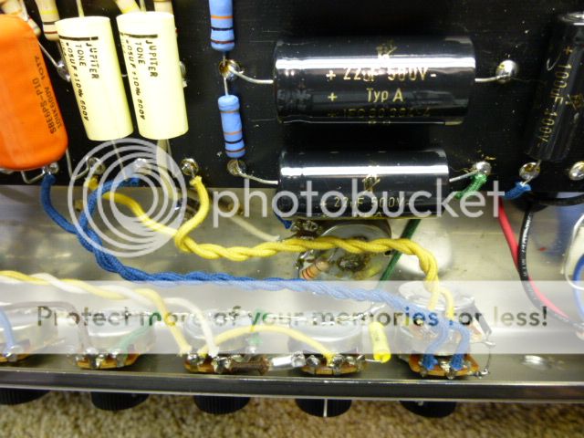

Picture of inside the amp may be usefull.

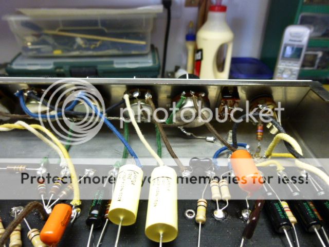

Here are the pics I promised.
Had 1.5K grid resistors and I changed them to 10K. I really couldn't hear a difference. Maybe I need to go larger still. I then put a 250pf cap across the PI entrance resistor, per TBN's instructions. And I have to agree that it does sound smoother, especially after a big chord when the amp is overdriven. The distortion is less fizzy as it trails off. But I still have the ringing aspect of the sound, maybe less pronounced. Maybe I just need to shave some high end off, but only the extreme audible highs. I have a 390pf cap in the tone stack, which is blackface style, in place of the normal 250pf. If I use a larger cap there will that help shave those highs or just let more mid-range through?
And here is a shot of the TEC! I used a poly-styrene cap.

Yes: 2nd & 3d pics have a black wire from speaker jack to the board.
That dual pot on the far right - is that a PPIMV? If so, try to move the twisted blue wires as far away from the other controls (especially the tone controls) as possible.
Good luck,
Stephan

And btw I am not familiar with this amp. Does it have a cathodyne PI? I would pull the twisted yellow/white wire pair as far away from the tone controls as possible, too.
Good luck,
Stephan
