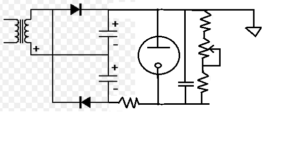

I have a bench power supply that I am able to tap 64 VAC off of for a bias supply and I just want to make sure I am seeing this correctly....
I came up with this schematic to use a bridge rectifier, and I just wanted to make sure that this looks OK to you guys...
Thanks in advance for taking a good look at this one for me  :thumbsup:

Put another cap to ground right after your rectifier.
64vac * 1.414 = 90.5v, 90.5v - 1.4v = 89.1vdc (the 1.4v is two diode drops through the bridge).
You have 37.2kΩ from that 89v to ground. 89v/37.2kΩ = ~2.4mA
Taking I2R for each resistor shows you will not come close to overheating those resistors, so their power rating is fine.
2.4mA * 10kΩ = 24vdc
2.4mA * 35kΩ = 84vdc
= 60v of bias voltage adjustment, from -24vdc to -84vdc.
With a single-turn 25kΩ pot, that may be too twitchy to get fine control of the bias voltage. Also, I doubt you will need -84vdc for bias (but maybe you will if you get adventuresome and build a triode output stage or something).
I'd think you'll want a multi-turn pot for the 25kΩ and/or increase the size of the 2.2kΩ resistor.

Most older Fenders schematics show the pot wired this way though it might be a consideration to short the one side to the 10K; if for any rare reason the pot were to lose contact, you won't have your bias floating out into never never land. Changes the span a little me thinks. I actually had this happen--but just like college, found out it was just bad pot.  :laugh:  Regards

If I can suggest an architecture for a Bias Power Supply circuit I'll suggest this
of course you must arrange the values of the voltage divider as to suit your needs
The presence of the diode permit a quick charge of the 10uF capacitor and a slow discharge if there is a problem due to fuse blow, the purpose of the 470k resistor is to avoid problems if the wiper of the pot fails
EDIT: Now the schematic is correct, previously, as noted by Steve, there was a great mistake and the bridge was draw backward  :sad2:

On Zen's dwg, (good idea) I would have the wiper shorted to the OTHER (more negative) end terminal so that if the pot wiper failed, the bias would snap to the NEGATIVE side and tend to shut off the output tubes.

Well if you're stuck with the bias winding on the mains transformer output and you're putting that tranny on a variac.....and you want to get all tooby and everything.....then you should use a voltage doubler on the bias supply (using silicon diodes) and feed either an 0C3  (octal) or an 0A3 (7-pin) 75 volt gas regulator tube.  :laugh: These will start/fire on the inrush current and require about 10 mils to keep running. Then place a voltage divider downstream from the reg tube that pulls 2-3 mils, including a pot in the middle of two limiting resistors, and your bias will stay steady even with changes in the B+ supply as selected by the variac. Fun!

OK, I adjusted the schematic to reflect some of the changes suggested...

You shun the opportunity to add another tube to your project? Especially such a cheap one that uses no fil current and lasts forever and glows pink/purple??  Shame on you!
Ooopps...I got the reg tube upside down. Now fixed. Dot down, plate up.

Yup. But there's no easy method of knowing or assuring they (B+ volts & bias volts) would track each other on any kind of predictable basis and you'd *want* them independently adjustable if you are really in the breadboard mode. The idea of the reg tube is you would have a way of them NOT moving together and then of course diddle the pot to control output tube current. You could of course use a 75 volt zener but......what fun would that be?
Actually, I believe the 75 volt reg tubes glow ORANGE (neon) vs Purple (argon)

K, your bridge is backwards and will produce a positive bias voltage with reference to ground.

Yes Steve you are right, I apologize  :worthy1: :worthy1:
I've redraw the schematic from Jschem to FidocadJ and I've done that BIG mistake  :BangHead:
thanks, I'll correct the schematic
