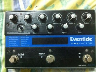

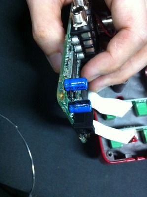

and i am interested to mod my pedal capacitor and Opamp. it always sound more better. i hope to share what i know to everyone. and i hope someone can give me suggstion.
i hope discuss with everyone about the opamp and capacitor.
recently, i mod my Eventide Delay , original cap is jamicon (made in Taiwan). and i mod it to BC cap and change opamp to AD .
« Last Edit: May 01, 2012, 12:40:10 pm by kwm488 »

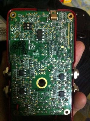

sorry to upload more. once more mod for TC Hall of fame reverb. it use lot of SMD caps and use programming clip, so i just change 4 On 33720 opamp to my favour AD 8620. and i change two filter cap from nichicon and Wincap to BC. i just do it today. i do compare before change it. it really sound better.
i learn from my to use solder to remove SMD opamp.

« Reply #47 on: May 07, 2012, 08:09:09 pm »
thank
and do anyone know what brand of this cap?
also, i change the 2 nover caps to nichicon.

Offline kwm488
  • Posts: 406
Re: My friend feel very upset of New Ampeg SVT VR
« Reply #49 on: May 07, 2012, 08:34:33 pm »
I record sound clip before changing caps. But I can't listen any different. And I just receive ampeg schematic, that caps for DI.
Sluckey, do you know what brand of blue color cap?
