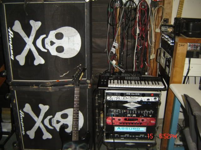

Oh, I like this thread!!!, Heres my shop.
