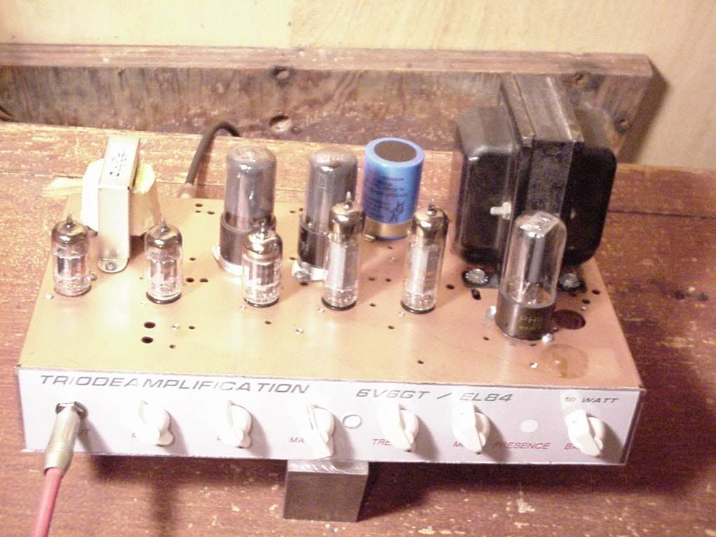

I am building another Marshall 2204/Plexi AB switchable channel amp. This time i am using 6V6 & EL84 power tubes
I think i am going to use a footswitch to switch between each pair of tubes but i would also like to do what Egnater used on there Rebel 20 to blend both sets of tubes using a Mix pot
I have been thinking about how they are doing this but i dont know if i am in the ballpark or not
Could the Mix pot on the Egnater Rebel 20 be just a ground reference for the cathodes for the 6V6 & EL84 tubes
The pot wiper is the ground and the L&R terminals are cathode for each set of tubes
Some how that doesnt sound right

About Rebel 20 schematic
To me it seems they are using four ganged pots in a PPIMV
I repeat it seems to me
if you use two double ganged pots you can decide the % for el84 and for 6v6 to be mixed

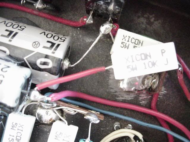

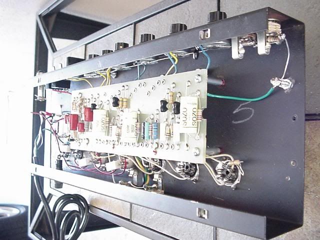

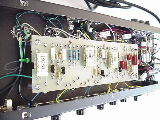

« Reply #5 on: April 12, 2011, 08:32:02 am »
I repaired a Rebel 20 last week that needed a new B+ fuse block. For 2 days i told myself to take it apart and get a bunch of pic's
I didnt. I only took pics of the work i did.
« Last Edit: April 12, 2011, 08:36:16 am by plexi50 »

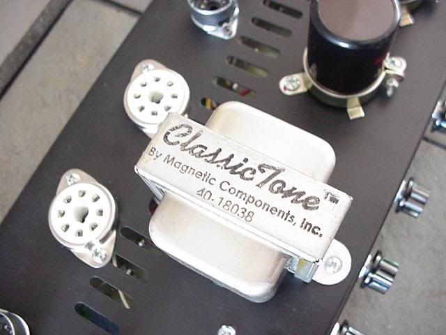

That'd be nice, but sadly no. It's TOP SECRET EYES ONLY and I don't have clearance. I got this schematic off of someone on this site. Don't know where it came from. It's just interesting to see how it's wired. Looks like the 6V6s and EL84s are on all the time and we're just adjusting the inupt signal to each pair. Wasn't expecting that. I was thinking it was something like what plexi50 was saying at first.
Generally we'll use a 8K transformer for a pair of 6V6s or EL84. Since we're using both at the same time do you think this is a 4K?
I investigated very about that and the result is YES that is easily a 4Kohm OT

« Reply #11 on: April 12, 2011, 08:35:33 pm »
The only reason i did not remove the preamp board ,take lots of pic's and layout the Mix pot is because sometimes when you start fooling around with this stuff some thing is lible to come loose and then i would have created another problem
It wasnt my amp so i did the right thing by repairing it and sending it on it's way

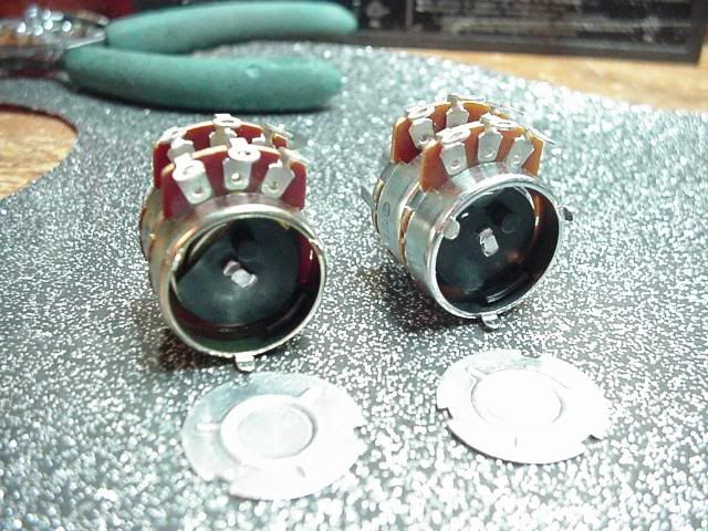

The PI and power section have 6 pin connectors and the mix pot has only 5
Yes, but did you noticed that two of the pin in the 6 pin connector are shorted ?
EDIT:
I've just find this, may be it can help
The Watts control is indeed a pot in series with the PI cathode and 470R PI bias resistor. It is 25kB with 33k in parallel (to give a log response). This simply cold-biases the PI as you turn it down, effectively reducing the magnitude of the signal going to the power section. Quite useful. Things do start to get warmer, more compressed, and a bit muffled as you go down, but a worthy sacrifice to reduce the amp to lower practice levels. I implemented this on a Marshally build and found it a good tool. A variation of this control can be found on the Carlsbro 60T amp where the PI grid leaks are made variable.
The Egnater tube blend circuit is a 4-ganged custom 500k pot that is tapped; custom piece. There are two output coupling caps per "leg" on the PI, one for each set of tubes (EL84s and 6V6s). Essentially the blend control acts as a balance control creating an upside down parabola if you were to graph it. Pretty cool, but not easily cloned without a tapped 4-gang pot.

 Has anyone out there with a rebel 20 ever pulled out the 6v6's and see if you can turn off the amp with the blend knob or would that royaly screw things up? If so then I'll take back what I said about not being able to shut one set completely off. To me, looking at the schematic, each set is never completely off.
"The Egnater tube blend circuit is a 4-ganged custom 500k pot that is tapped"
I can't see from the schematic that it's a tapped pot. I thought a tapped pot has a terminal somewhere along it's resistive strip between the two lugs. Can anyone enlighten me?
« Last Edit: April 15, 2011, 07:54:20 am by jeff »

Wire each gang pot opposite of the other so the master would swing in opposite directions for each set of tubes?
At center position on the Dual ganged pot you would have both set of tubes operating at half there potential signal strength
Thus the Mix?  Scratch all that. Do they make a 1MA single 4 gang pot? Im gona go look  :think1:
Heres  long shot! Cut the shaft and or threading as needed to butt the shaft to the inside rear of the front pot
Solder 4-5 heavy gauge buss strips across the pots like a cage to keep them in line
JB Weld the shaft to the rear wheel of the front pot
I dont see much online about 4 gang pots other than they are very exspensive hi-fi stuff and are rarely available when they have them

May be there was a bit of confusion, I've read "four ganged tapped pot" as a pot with intermediate intakes (phisiological intakes - one for each pot) but now I seriously doubt about that.
The diagram is using master controls for each set of tubes?
This is how the tubes signals are mixed?
Yes
Are we using a single dual gang master pot to swing between the pair of tubes?
No we must use two dual ganged pots
Yes,  using pots like those in the photo you posted (no all pots are good for that mod) think that you can obtain a 4 ganged pot
there is also another solution, you can use composable pots (they are produced by Tyco)

I built this using the chassis from an old Crate G40C SS amp
Not pretty but good enough for me / Now to cap off all those holes with some christmas lights :w2:
« Last Edit: April 21, 2011, 01:13:58 pm by plexi50 »

The first build 2+ years ago does not show the finished product as i had to make many changes because of front panel space
I have the finished pics' some where either on PB or youtube.
My first combo 6V6/EL84 build below
« Last Edit: April 21, 2011, 08:43:30 pm by plexi50 »
