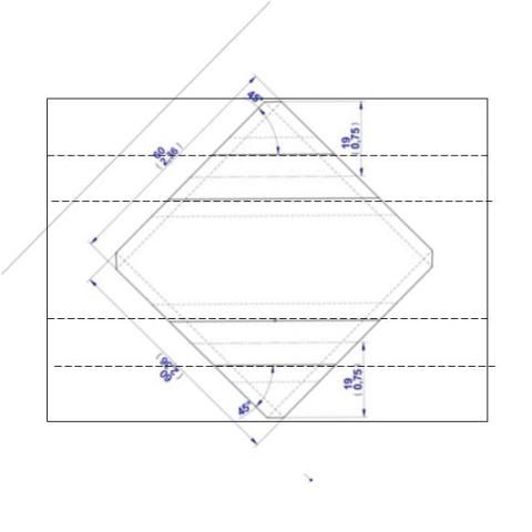

I am just trying to find things to do when I Retire in March
Anyway you can not do the cube at 70 degrees
you would need a 20 degree dovetail cutter
they don't make them [ Google it ]
you can get 14 and 18 degree cutters
14 gives you 76 degrees
18 gives you 72 degrees
http://www.toolstoday.com/c-356-dovetail-router-bits.aspx
I am making them with a straight board thru the router table then cut the ends off 45 degree and make the box
« Last Edit: January 26, 2011, 06:22:28 am by supro66 »

« Reply #5 on: January 26, 2011, 06:27:02 am »
That's what I did too. Much safer. But the wood grain direction gives it away. It's not obvious with small tight grain such as maple, but any wood with a distinctive straight grain pattern such as walnut or oak will give a big clue to how it's put together.

« Reply #7 on: January 26, 2011, 07:22:08 am »
I just used a standard 1/4" carbide dovetail bit. I don't know what the cutting angle is. I used a fence to plow one DT groove then flipped the piece to plow a second grove. Then I moved the fence a little to widen the two grooves to about 1/2" (don't recall the exact width). The mating piece was cut in a similar manner, but I 'snuck up' on the exact dimensions by moving the fence slightly and trying a test fit. It took several adjustments to get it right and tight.

« Reply #9 on: January 27, 2011, 12:09:03 pm »
That's what I was thinking
Why would you need an odd angled bit?
The combo of one right side up and one upside down should work or am I thinking goofy.

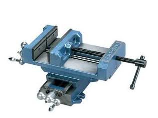

« Reply #12 on: January 28, 2011, 12:49:47 am »
http://www.use-enco.com/CGI/INPDFF?PMPAGE=472&PMCTLG=00
Hi Supro:  That vice looks a lot like the one in the Enco catalog. If it's the import be careful I got one of the cheapie chinee jobs and the threads have a lot more slop than advertised- and you can't index them fer shize. No repeatability. They're ok for non-precision stuff like chassis holes, but not much else. I got it with a Delta drill press with an 18" table, catalog said "made in USA" the unit said made in china. If I had been a little less desparate at the time I'd have returned it being as it was 900 plus shipping.

« Reply #14 on: January 28, 2011, 12:53:17 pm »
Yeah, you may need to tighten up the gibs and then buy two cheapie magbase dial indicators (plunge type) set on the two axis and watch them - certainly ignore the crank dial with all the backlash.  Don't forget to lock the axis you are not using.  I bigger concern might be your drill press.  Unless you have a true mill or an old 1200lb cast iron drill press head, it may rattle to death.  Lock the quill tight all the way up and set your depth with the table.  Take it slow and hope for the best.  Or buy a router!

The vice is on it's way from Amazon.com
